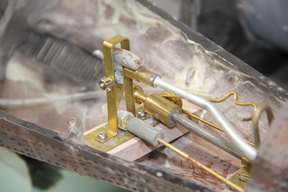

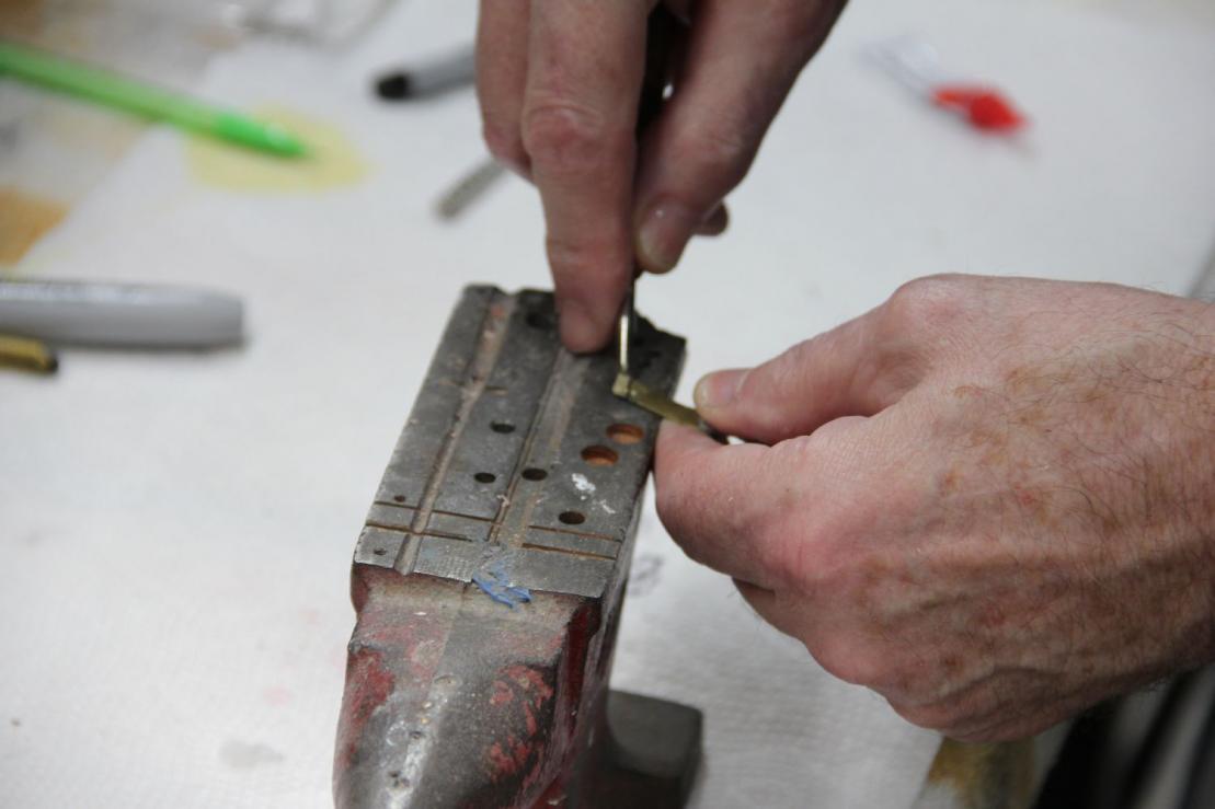

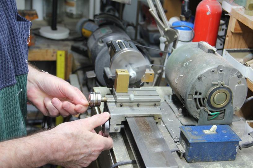

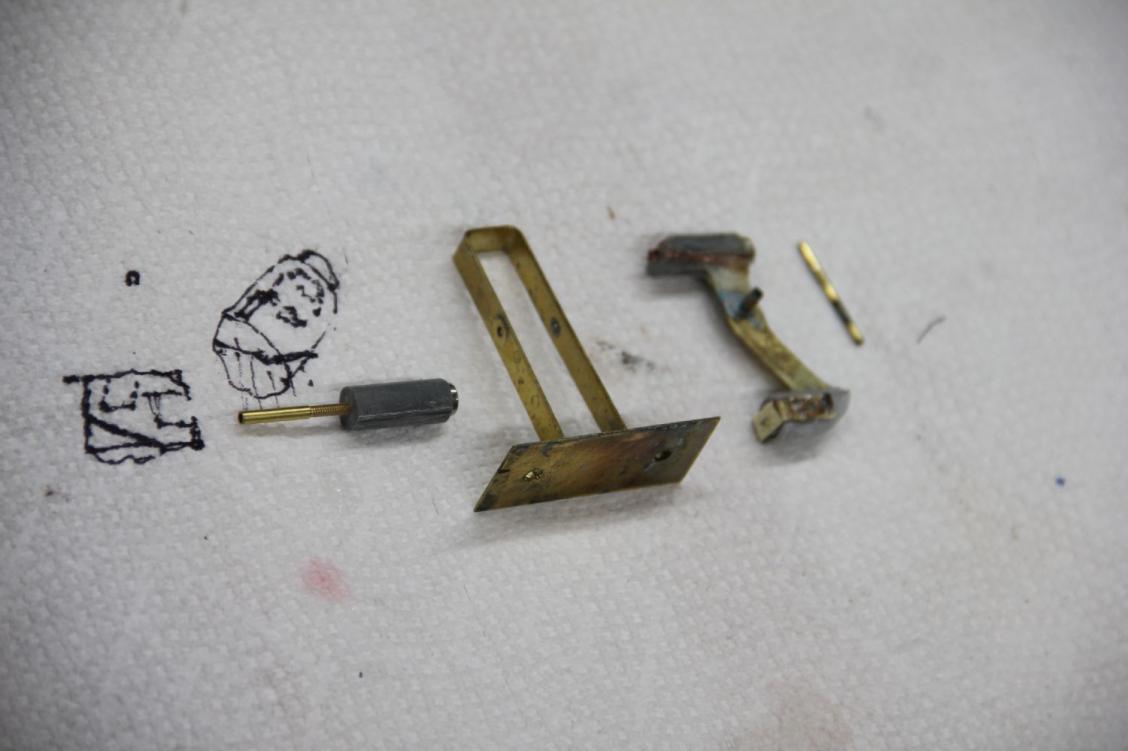

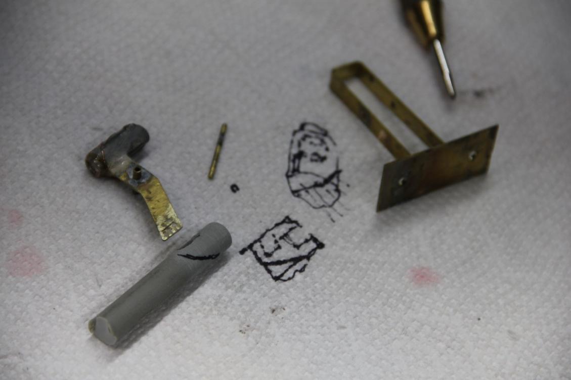

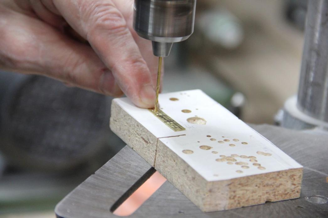

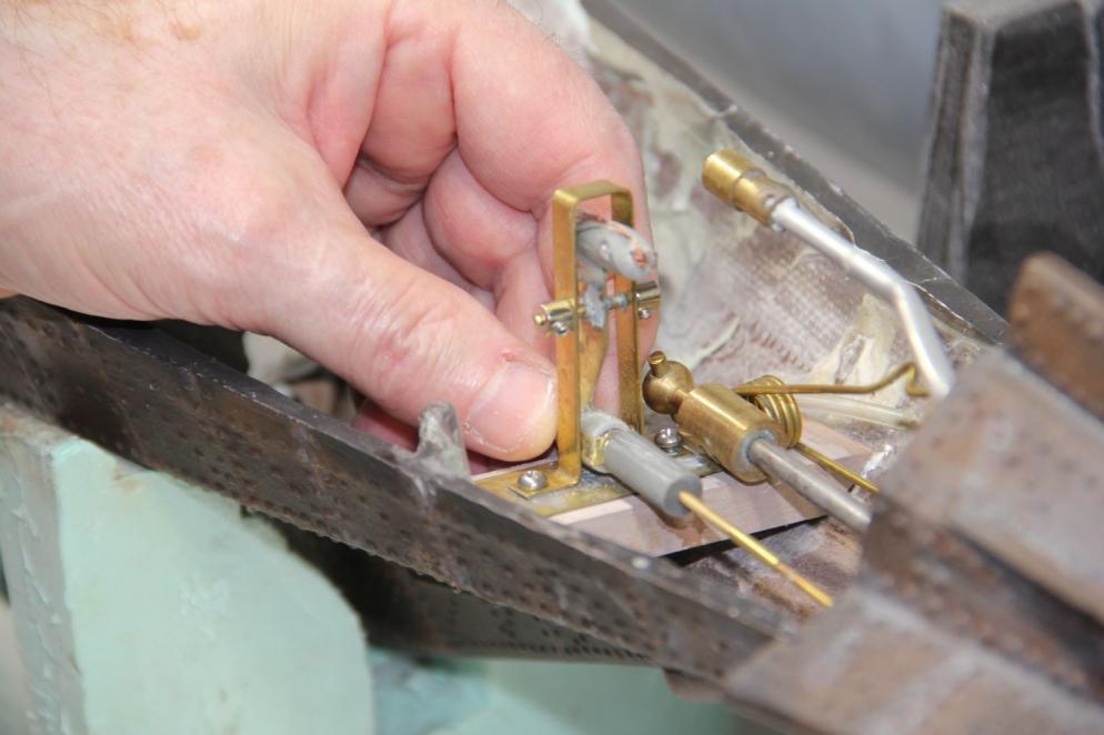

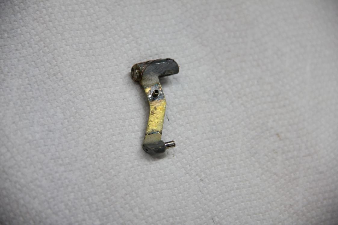

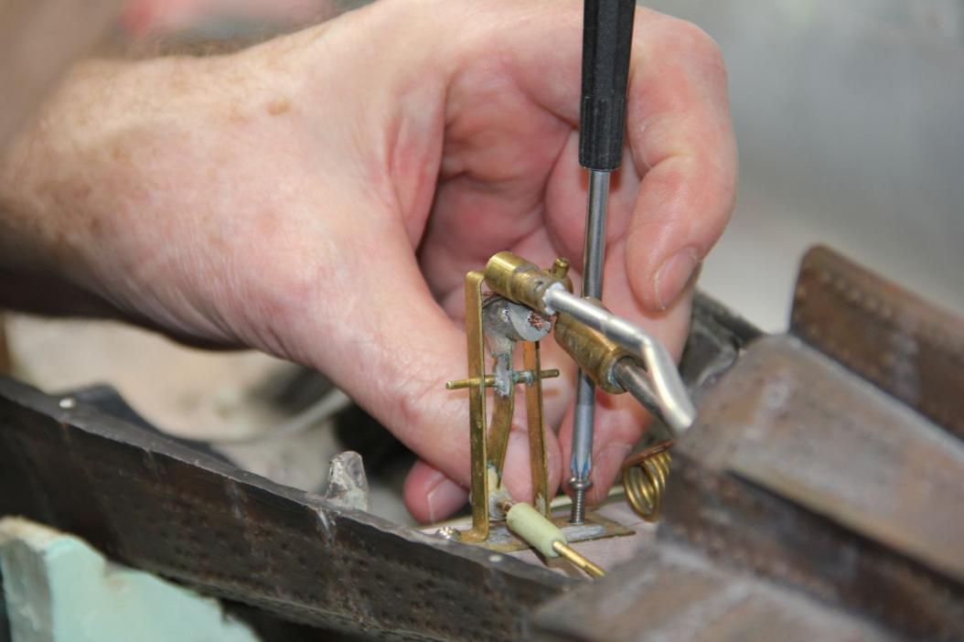

              Today, I got with Merriman to address an on-going rudder issue we had on the Nautilus that started Friday while at Cohutta. We thought the issue was corrected, but it kept rearing it's ugly head and Dave had an idea to finally kill it, so today that happened. Dave made a new interface between the actuation of the servo to the rudder which incorporated a much larger magnet. The magnet was also shielded by a u-shaped piece of brass sheet. Before the rudder linkage was coming uncoupled from the magnet on the operating arm from the servo. This was very much high-lighted when running in reverse. I'm confident that this will be more than sufficient to adequately control the rudder. Still have to test it. Click image for larger version
