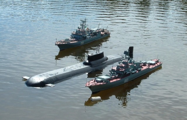

            Nice! Who made the hull?? APS Models here in OZ used to produce a 1/72 Typhoon he only made a handful of them due to the extreme size (for a sub) same length as a Spruance class DDG in 1/72.
            Here is a pic of One with escorts!
