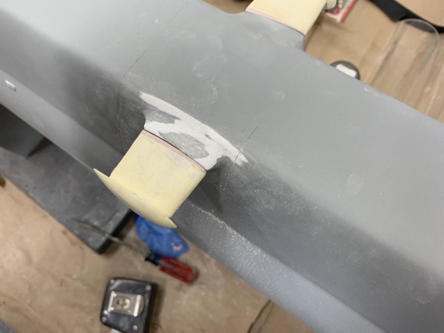

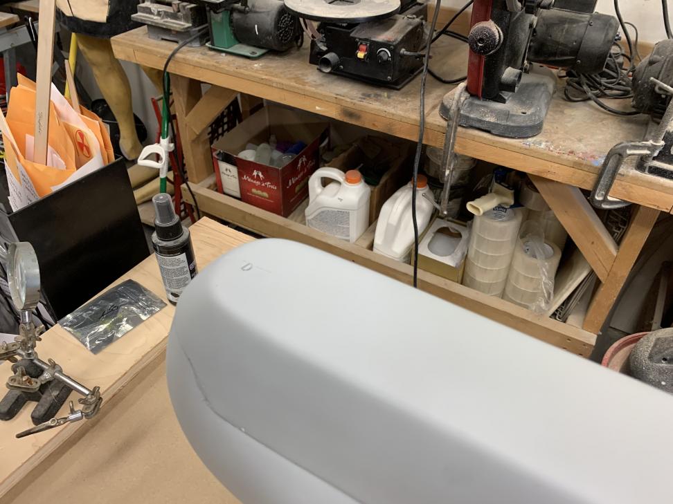

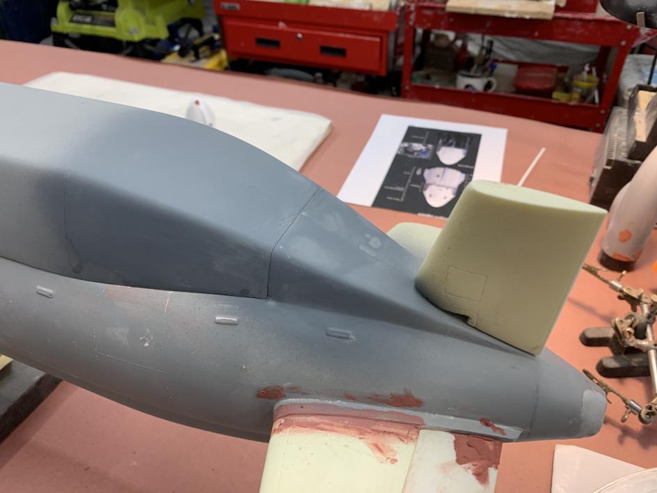

            A bit more done yesterday on the 214. I haven't found much to complain about. The hull is polyester resin. I knew that the minute I started grinding and drilling but very low smell compared to others I have experienced. That means the mixe was catalyzed correctly and not over catalyzed. There were some voids in the gel coat which is typical and easily and quickly repaired by Apoxie Sculpt or Evercoat. But I only found two.
            In looking at the original build from the maker of the kit I noticed he didn't Z cut the deck but rather used and single screw in the bow. You can see it in the pictures on the website if you look close.

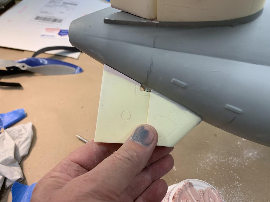

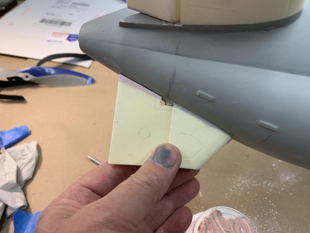

            Appendages are a little gappy to make up a word but again easy fixes with Evercoat and a file and sand paper. All the appendages and bearings are secured with Apoxie Sculpt. They are rock solid and true. Very easy to rotate and move.
            More tomorrow.

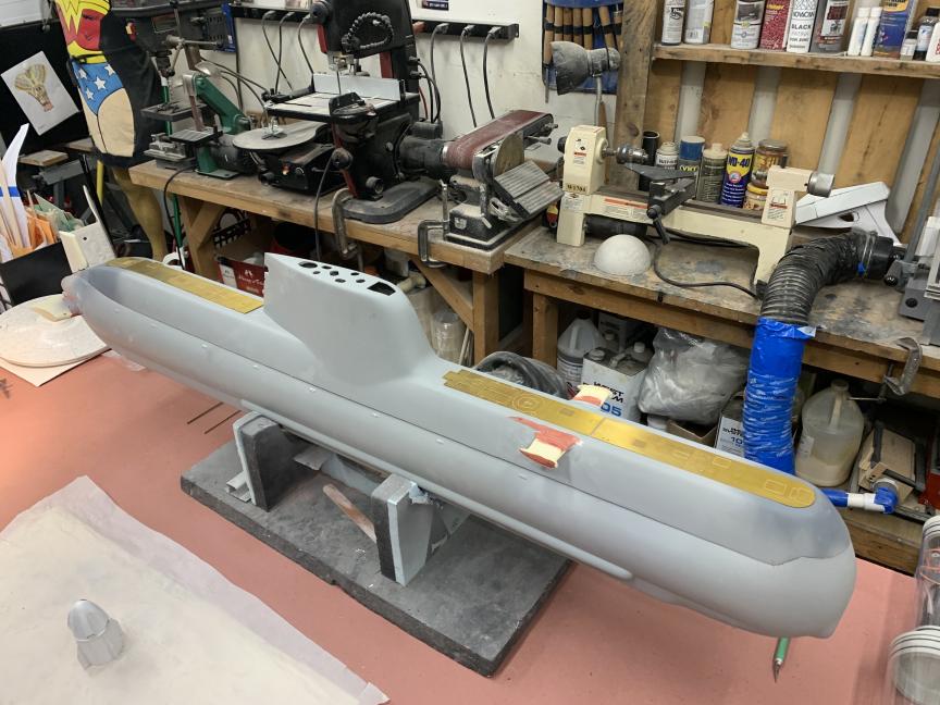

              A bit more done on the 214. What I did is mount a section of PVC to that piece of thick plastic I placed the day before. I cut it at an angle and glued it in position. I used calibers to determine its needed length. I was within an 8th of an inch of the deck. I then filled in the hallow with Apoxie Sculpt and placed some plastic rap over it and pressed down the deck. This gave me a perfect fit and when set up today I can drill and tap for single screw hold down. The excess will be trimed off for a clean look once the Apoxie sets up.
              The stern end of the deck has a flange and it fits into an Apoxie slot I made. It can't move laterally and is solidly in place.
              Today it's point up the gaps and fit to the filets and hull. Then some scribe correction and she will be ready for primer.
              • SteveNeill
                • Apr 2020
                • 315
                The single brass screw holds the deck down so well I can hold it up by the deck. No Z cut needed.

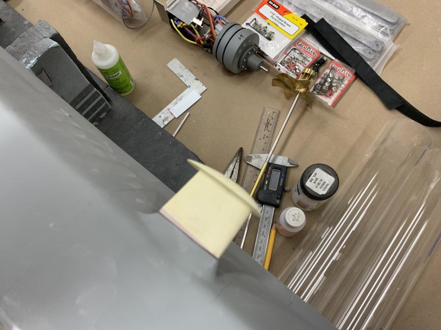

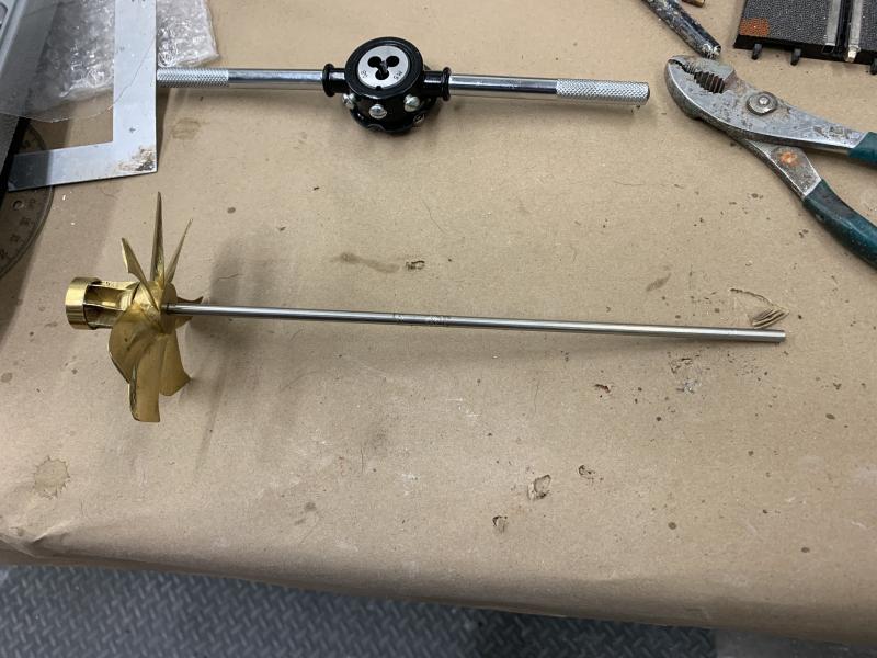

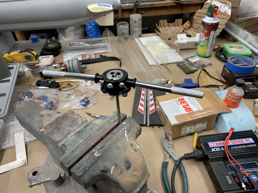

                            So I learned at long last how to thread my own prop shaft. Thanks Bob for telling how to do it I felt like a dummy at the time that I had never used a die. I used taps but never a die. My first attempt somewhat scared the prop shaft. I need a different vice that won't scare the shaft. Threading stainless was not easy. It fights back hard and kept twisting in the vice. Maybe I was turning too hard and bit my bit probably works better. The experts here will tell me.
                            However I got it to thread, made a bulkhead to support the shaft and got a good look at this pretty prop on the boat. Bob

                            The other problem I ran into was the oilite bearing not fitting the 3/16 shaft. I checked it against a 3/16 wheel collar and that fir fine but not the bearing.
                            Today I'm back to blending the appendages and getting the brass on. Then I plan to get the cylinder installed and all the linkages hooked up and working before I start primer and paint.

                              So the new prop shaft is inbound from Bob. Bob was kind enough to die thread and new one for me straight and true with all the bearings I needed. Won't have it until Monday but I have plenty to do on the boat until then.

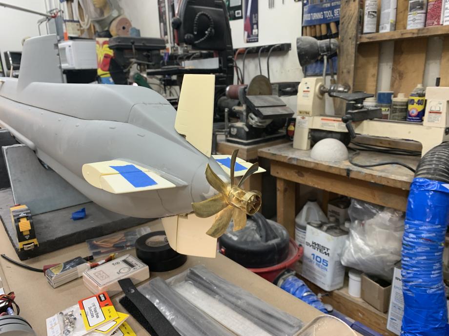

                              The hull has it's idiosyncrasies like all garage kits. I had a large gap between the deck and the stern. Easy. Evercoat and red air cure putty. Then there were the gaps between the appendages and the hull. Easy. Painters tape against the hull and Evercoat. Sand and shape.
                              Started figuring out the place of the brass on the deck and will install tomorrow. With any luck and a strong breeze I should have paint on this boat by Friday.
