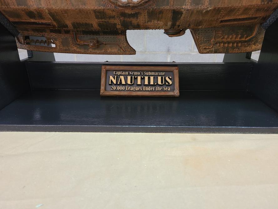

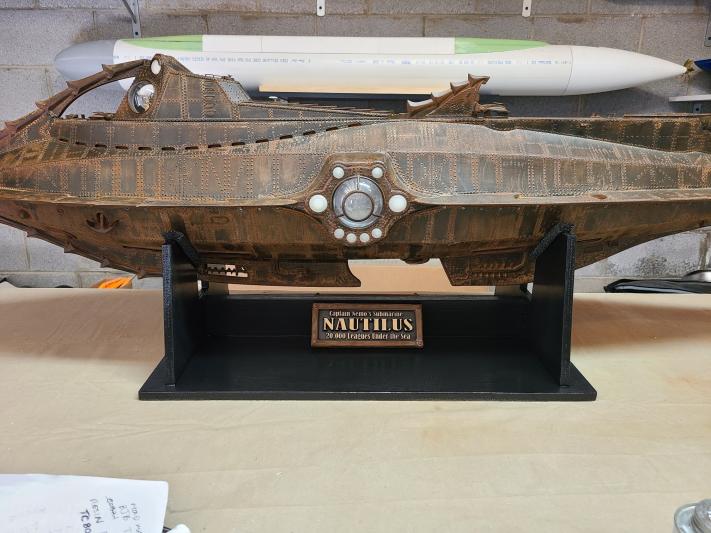

        Ok, happy to report that with the new 8A BEC she hasn't had one issue. Powers up every time. Thank you David! As a result I was able to work on the static dive trim and it is close. I was also able to paint the base and I added a couple of nifty plaques that Bob printed out for me. They turned out really good. Looks great!
