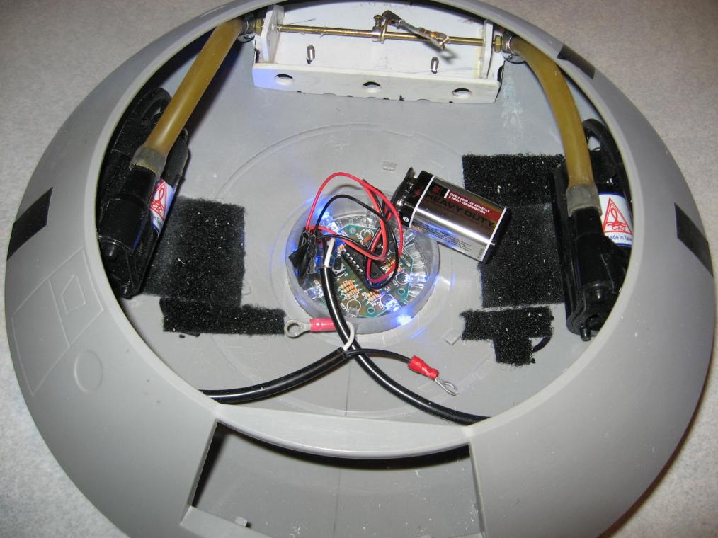

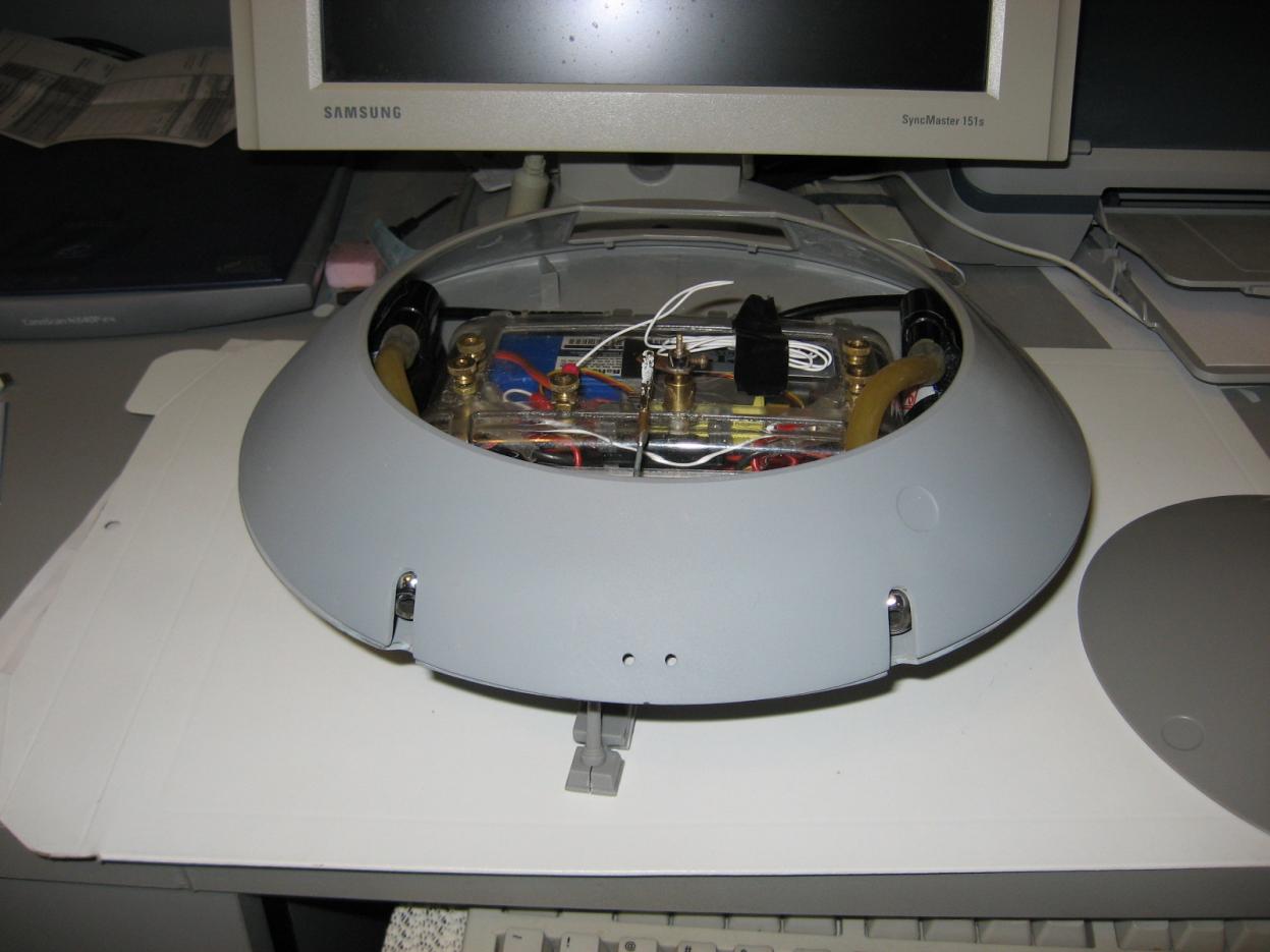

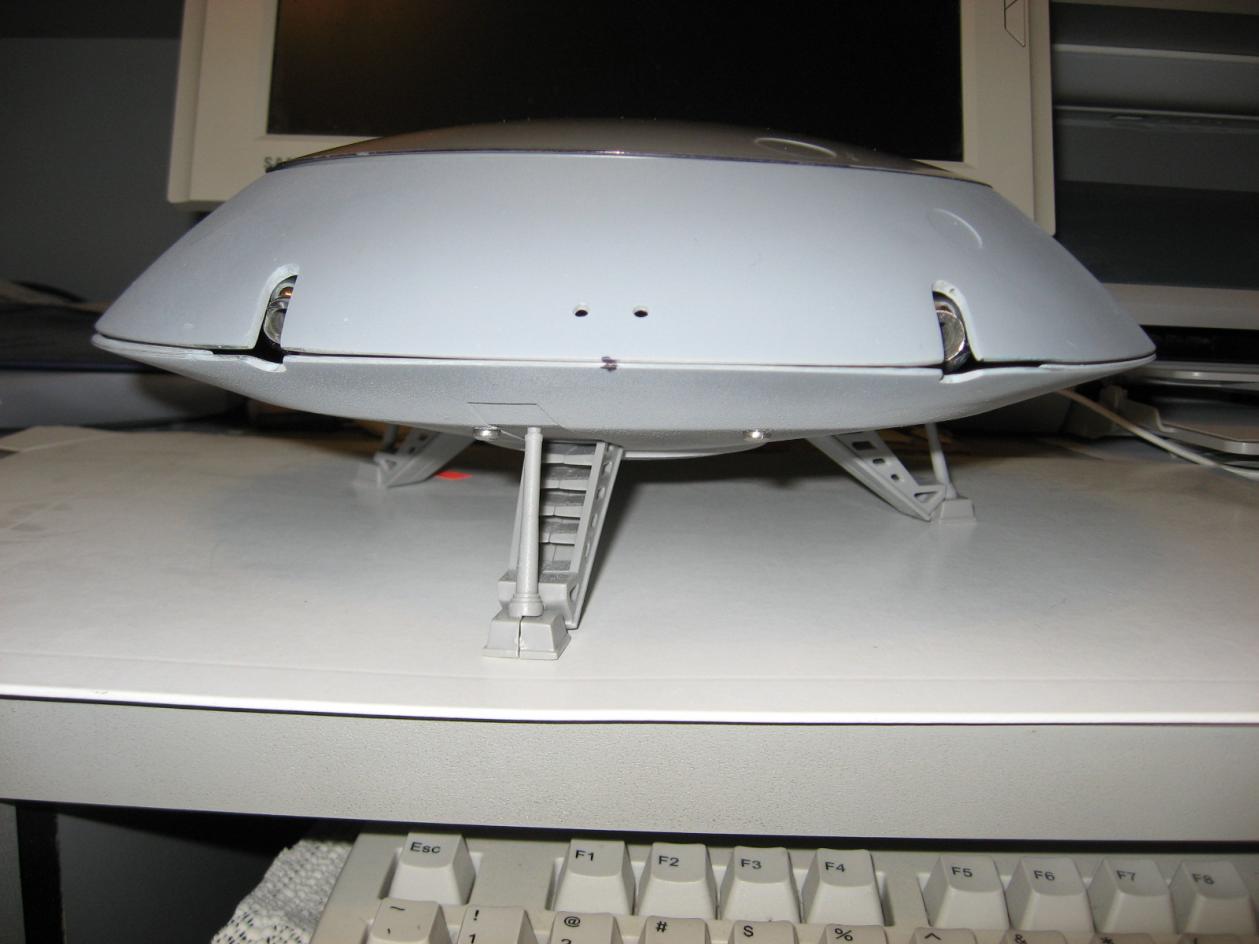

    Here is the 12 inch polar lights jupiter 2 "from Lost in space" t.v series that I am converting too r/c for fluidic space flight.

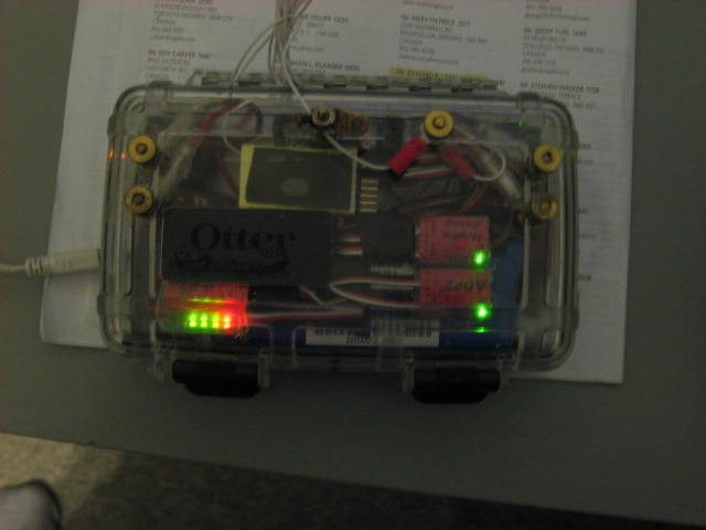

    I am using an otter divers box in place of a sub driver/ wtc as it was in my pile of **** and fits the bill.
    The sub/ ship will be dynamic diver and is propelled by a pair of small bilge pumps run on a 2.2 amp 11.1 lipo all controlled with Kevin McLeod electronics and sombra labs reciever.
    Tub test have been satisfactory... most satisfactory ( DR. Beaker supercar) but need big pool test too see how the saucer shape will preform in flight.

      Rick, this is obviously a adaptation of the systems you use to propel the Proteus and the flying sub models of yours. What are the exhaust nozzles made from. Good idea. Im wondering, I have seen videos of the flying sub model in action and it seemed to have a tendancy to "hunt" or not maintain a steady course about the yaw axis. I figured that , that was a consequence of being rather flat nose. Does the Proteus have the same tendency?

        Hi Dave and Mark.

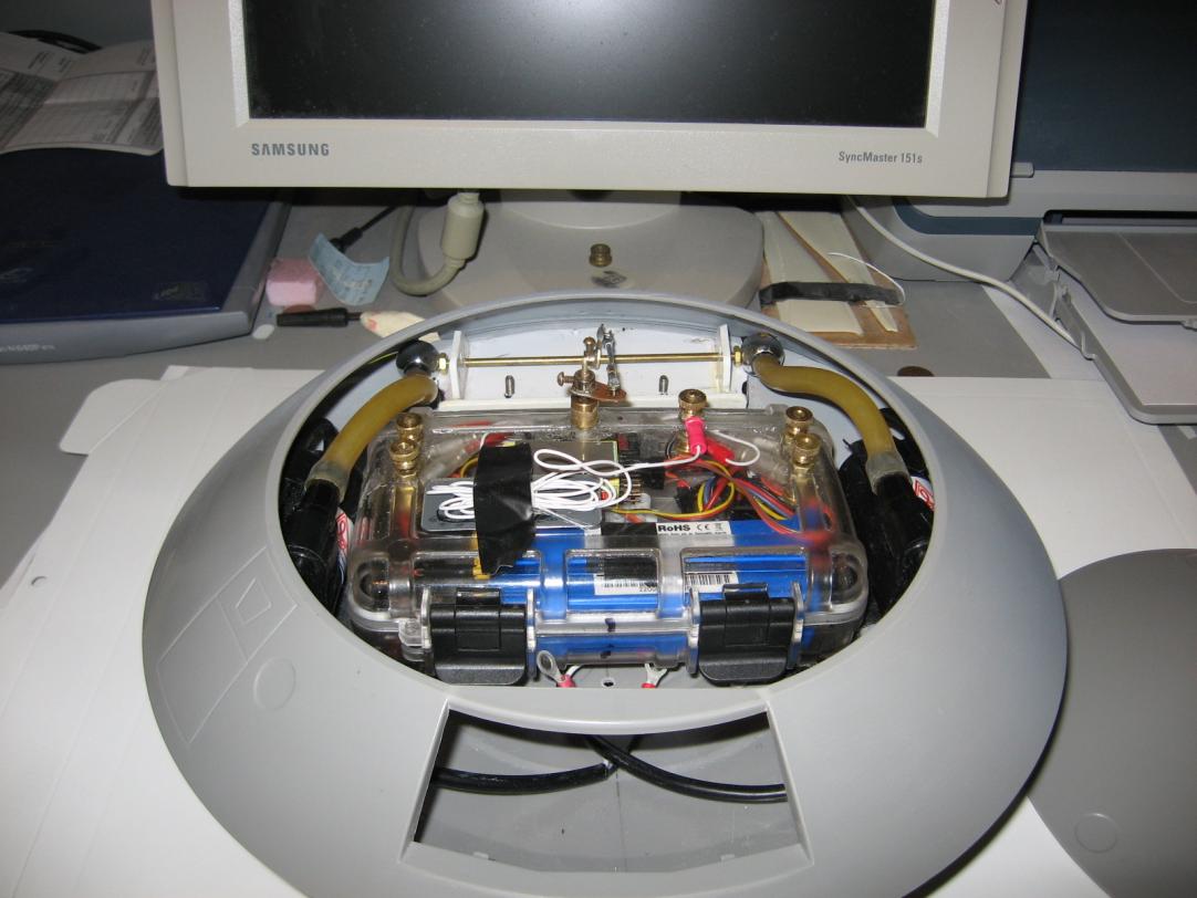

        I don't know what video you watched Mark but my fs-1 is pretty stable in " filght" and has a sort of built in depth keeper inherant too the design shape or the amount of foam that is in her or plain dumb luck!

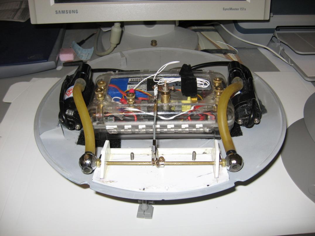

        The nozzels are made from a pair of 3/8th ball valves but a couple of pieces of pipe would have worked as well.
        From the pumps I use some 1/4 " bore surgical tubing which allows the pitch and the elasticity acts as a return preload if you will back too center.
        Proteus is a beast of a different color and no longer uses bilge pumps , I switched too a pair of ducted pump jets made from a hot air curling iron that the wife was going too trash, they reminded me of Daves rotor and stator pump jets he made for fs-1 and Seaview so I recycled them befor the last Indy reggatta.
        So far Proteus preforms well enough for another fantasy ship.

            The new Moebius J2 is much bigger.
            • Rick Teskey
              • Jan 2009
              • 265
              Yes it is and I have one of them as well, but since I have this smaller one I thought I would start small and see how it behaves.
              The 18 inch has more real estate and begs for a ballast system and retractable landing gear , now if I can just find enough deturium too power the fusion core ....
