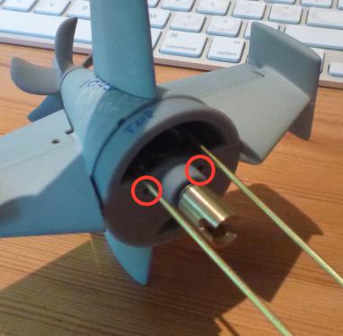

                    Nice Job on your Blueback, I'm building one also. I'm at the point of putting the tail cone together, is there some trick to getting the control rods connected to the yokes in the tail section after it has been put together, other than a lot of patients?
                    Ernie
                      Well done Ernie. Its a great boat to build and to run. The only thing that you have to do is to ensure that whatever tool you are using to tightern the grub screws in the rear yolks will fit through these two holes.

                      Loosen the screws, retract the plane operating shafts a bit and let the yolks fall out (remembering their orientation). Then thread the control rod "Z" ends through the yolk horns (gently - they are a thight fit to prevent slop in the control system). Replace the yolks, reinsert the operating shafts and tighten to a snug fit. DON'T overthighten the grub screws - this is white metal not titanium.
