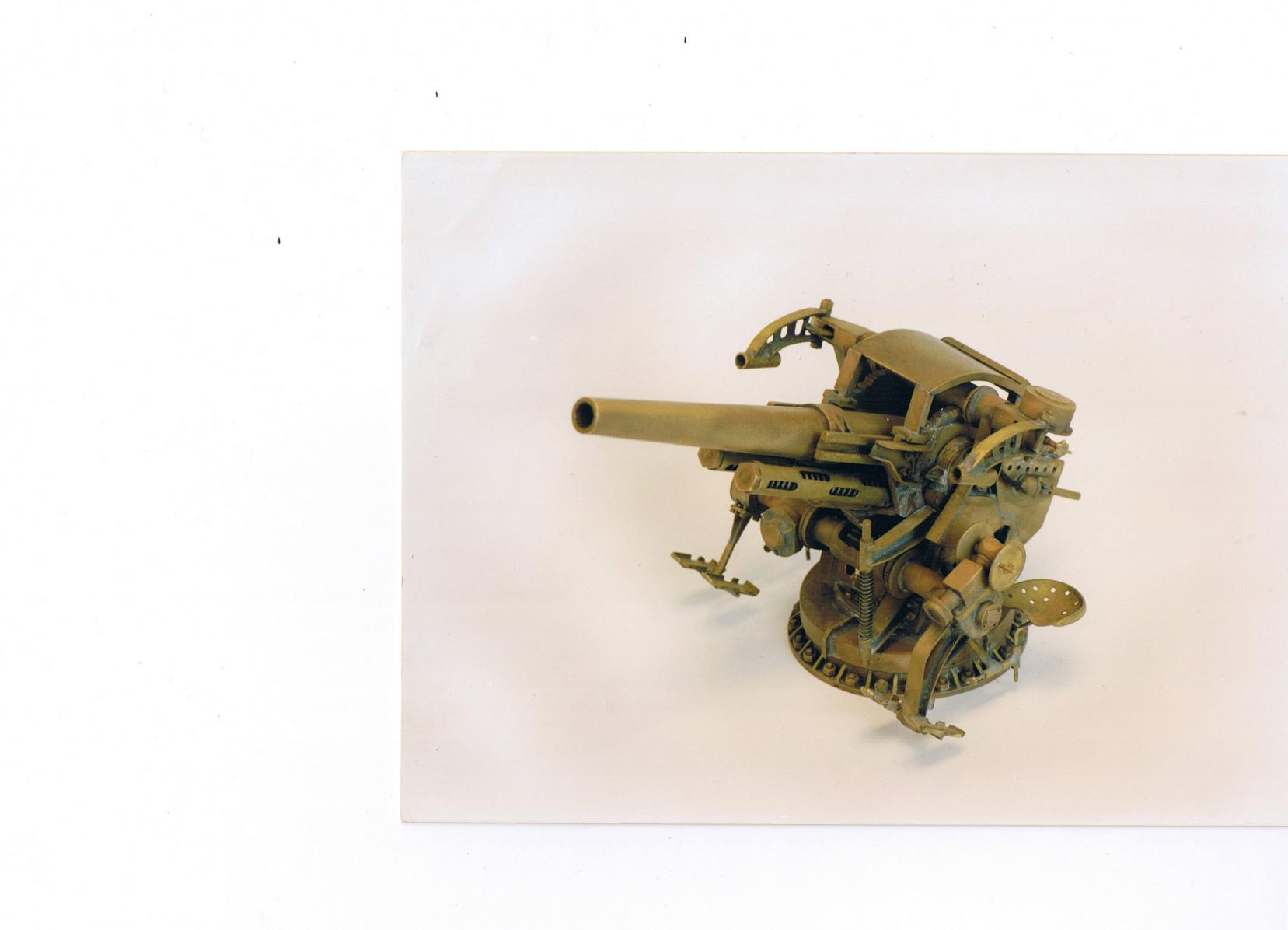

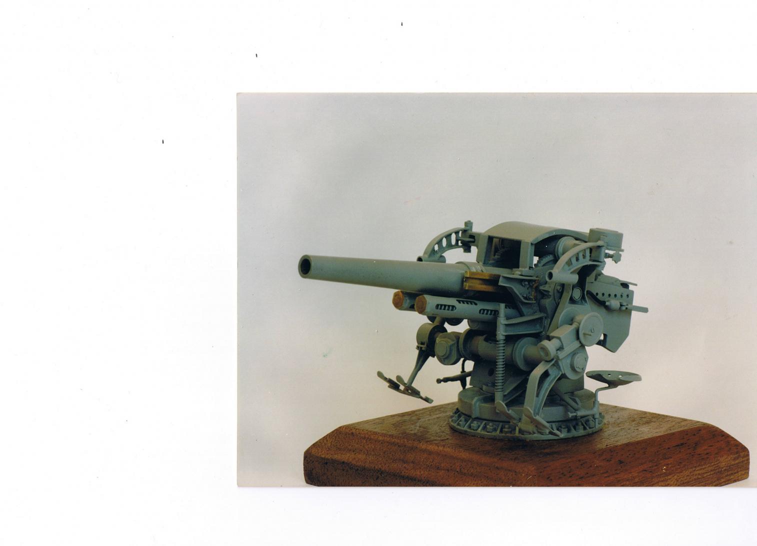

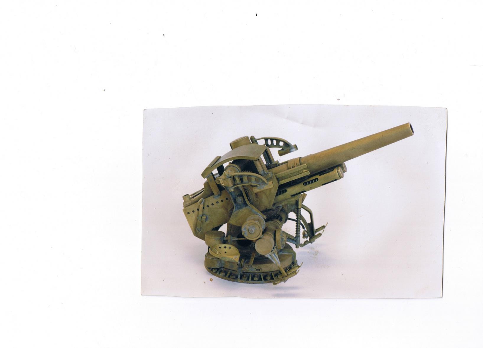

    Some years ago I purchased on of 32nd Parallel's Gatos, huge bloody great thing it was and I had a lot of trouble this side of the pond getting info to make a half decent job of it.
    The biggest problem was the deck gun, I had drawings and photos but just couldn't get a feel for the thing. There were model kits around at the time but none seemed to look quite right compared with pictures so I set out to get it as near as I could.
    A trip to the naval museum in Washington did the trick for me, they have an actual gun there so I spent a day with a ruler and pad to make up my own drawings and figure out what parts did what. By te time I left I had a good idea of what I would do and attached are the results. The model is made entirely from brass and 5 different solders with different melting points so the thing didn't fall apart when putting together.
    I no longer own the boat or its fittings but sold it on part built to someone younger who might just live long enough to complete it but I am glad to say that the gun will one day get wet. Hope you guys like my efforts. My next problem is the 88mm gun on my U-Boat but I have found the real thing in Cuxhaven so a trip to Germany looks like a definite

    Ah nice to see this. I've heard about it, and seen Paul's Gato in pictures (it would never fit in my Mini!) but never seen the gun.
    Just as well they have a big old puddle at Norwich.
      • 13929
      Wow! Excellent work. Please tell me you have some in-work shots of these little pieces of Jewelery?!
      The rust is right where it's supposed to be, on the barrel slides and other in-motion elements of the gun. Love it. You are, and always have been, a Master at this sort of stuff, Ron.

        Sorry David but I don't have any construction shots of the gun, I didn't take these pictures, they were taken by a friend. The one thing I never mastered was a camera.
        There is no rust on the gun, what you see as being rust is the bronze barrel sliders, damper end nuts and on the left side the scale for the gun inclination. These are bronze on the real
        thing and bronze on the model, the rest of it is all brass. When I first built it the handles worked but I took the worm gears out so that if anyone yanked on the thing it would do no damage.
        Since those pictures were taken I put the rifling in the barrel so now it is there (sad puppy aint I) I almost completed the bridge of the boat, periscope shears, radar mounts, ariel mount
        (that works to) bofor guns,handrails,hatch cover and the strip decking all secured with over a thousand rivits but I have no pictures of that lot but I am sure that the new owner
        will post them in due course. I understand from mutual friends that he is making a superb job of the rest of the boat and it will make a fabulous model when completed. I,m looking forward to seeing it. I still have my original sketches so maybe one day! By the way, who do I have to screw to get promotion on this site.
