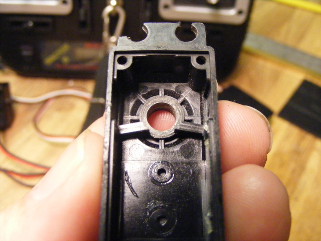

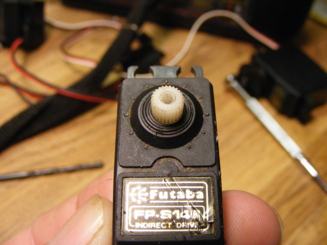

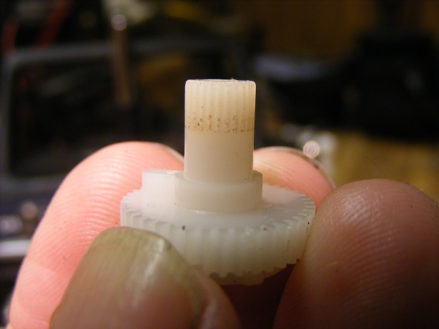

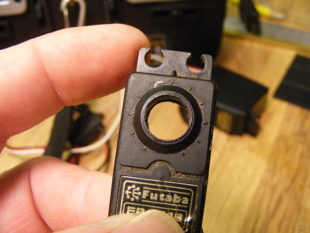

    No big deal. I wanted to put a servo up front in various submarines to control bow planes without having to put it in the Subdriver and then try to figure out a way to actuate the planes. It can be done, as many have done it ,but it just seemed to me to be a lot of trouble. So I purchased waterproff servos from Traxxas only to find out that they are not waterproff, by no stretch of the imagination. Fine then! I will just make my own. In my mind I am totally satisfied that if you use "Goop" to seal up all the seams and screw heads and wires ,no water will get in. However the output shaft is a whole different situation. I was told to put o-rings around it but that didnt work either. Thats because the shaft is splined outside of the servo case and no o-ring that I know of will seal a splined shaft. So , time to open up the servo and see whats under the splined area. As I suspected on the Futaba s-148 and newer s-3003 there is no bearing and you find a nice smooth shaft that we can work with.

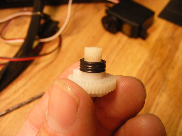

    Into my o-ring kits I went and chose a Quad ring that measured .208 x .070. This quad ring has a good interference fit to the shaft. While we are at it lets put two on there as we have the room and it will make me feel better. Now the case.

    To properly seal using these o-rings you have to drill out the case to 11/32". Here of course much care is needed to get the hole centered and in good shape because it is your sealing surface.

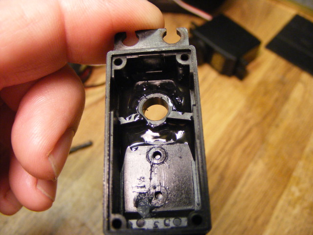

    However when you do that you must first apply some epoxy to the inside of the case in order to have a solid foundation to seal against after you drill such a large hole.

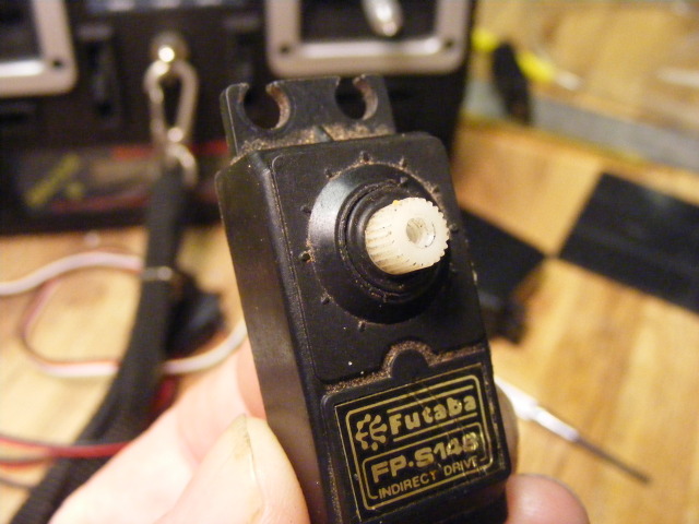

ID:	58495 Then apply silicone grease to the shaft and seals. Install first the seals into the case and then push the shaft through and push it all together and install the screws. Then check the operation of the servo to make sure we havent put the output shaft gear in oriented improperly. On the bottom of the gear you will find a tab that limits the extent of travel of the servo. If you get it put back wrong you will lose a great deal of servo travel. Just be observant of that when you pull it apart. When you are done it will look like this and you can then go out and defy the water once again! Oh yeah, dont forget to seal up the seams and screw heads and wires well or it will be a short trip. I use "goop" because it is thinner than silicone and spreads out and seals on its own without having to go back and try to smooth it out. Cheers
