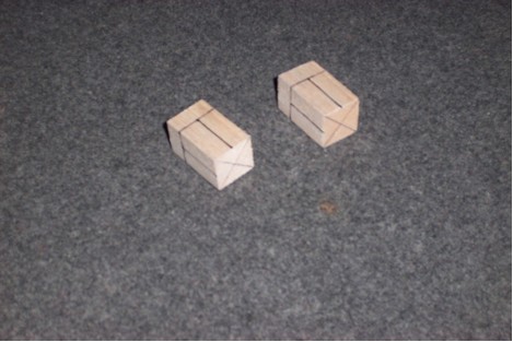

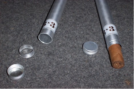

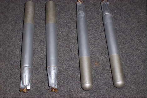

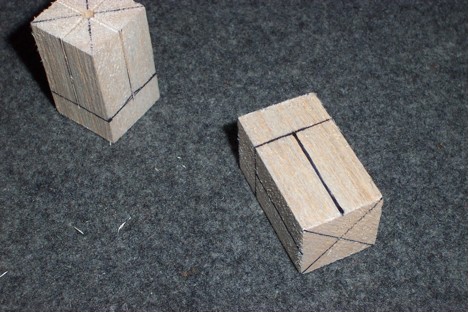

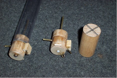

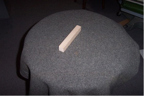

To start, cut the 1x1 balsa into 1 ¾ in lengths and mark out where you need to drill and cut for your stuffing box and fins. Then drill and cut them. I then cut the cigar tubes threads off at the raised rim and sanded them square. The balsa ends for the tubes are then sanded to shape so they are a tight fit in the tubes. Make the stuffing boxes out of the largest sized brass tubing, about 2 1/8” long, by soldering ¼” long brass bushings into each end and insert them into the balsa end caps. Insert the plastic fins and cut them to the length of the stuffing box. Epoxy all of the wood to make it water tight

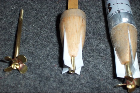

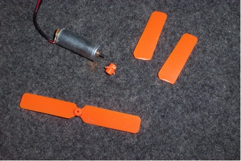

Cut the blades off of a propeller hub that came with the motor and slip the hub onto the motor shaft. It will help hold the fuel tubing flex joint to connect to the propeller shaft.
Drill out the threads of the brand new brass propeller to fit the prop shaft. The shaft should be made from the second smallest size brass tubing and just fit into the stuffing box bushings. The prop shaft should be about ¾” longer than the stuffing box. Solder the shaft into the drilled out section of the propeller.
Cut off the other side of the propeller hub and drill/grind it out to make a tapered hole all the way into the shaft. This will make it easier to load in the torpedo tubes when you can’t see into them. The smallest size brass tubing (3/32”) should have a nice slide fit inside the propeller shaft with no binding. Plug up the motor end of the propeller shaft by soldering it shut with a ¼” plug. Don’t forget to grease the stuffing box and run it in so it runs smoothly.

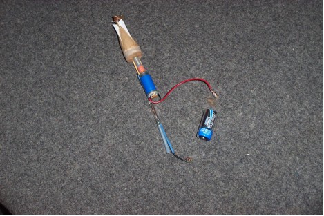

Remove the two wire plug from the motor wires and solder the black wire to the single side of the magnetic reed switch and shrink-wrap it. Solder a section of tubing to act as a conductor to the end of the red wire. Solder a short wire (1”) with a small section of tubing soldered to the other end to the normally closed side of the magnetic reed switch and shrink-wrap it. Isolate the other wire, the normally open side, from the reed switch and insulate it too.
Use a section of the popsicle stick to attach the motor to the end cap with the prop shaft lined up. I cut a slot in the end cap and epoxied it into the proper alignment. Use a section of fuel tubing to make a connection between the prop shaft and the hub on the motor shaft. Use electrical tape to secure the popsicle stick to the motor. I also used electrical tape to attach the magnetic switch to the side of the popsicle stick and the other end to the battery. I also used electrical tape to connect the two wires to the battery. Now, unless you have a magnet holding the switch open, your motor should be running. The magnet will open the switch stopping the motor. If it is turning the wrong way, reverse your battery.

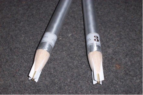

Stuff everything except the magnet into the cigar tube and check the flotation and spin of the torpedo. Put the magnet close to the torpedo to shut it off and remove it to turn it on. Bend the last ¼” of the plastic fins to help counteract the propeller spin a bit and allow it to go in a straight line.

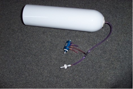

Launching Method

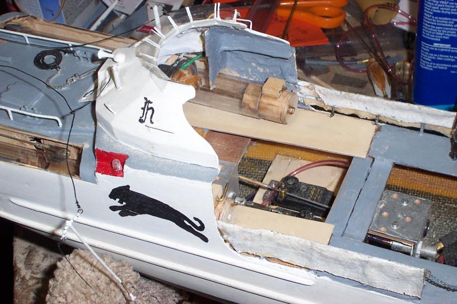

I believe air pressure is the easiest way to launch torpedoes, and it is an authentic method used in WWII. It has one moving part, the air distribution valve that is servo controlled.

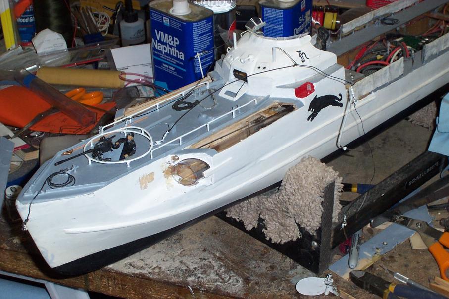

I cut the 1” plastic tubing to a length that included the angle at the bow doors, the length of my torpedoes, and the rear plug. The angle at the bow will be determined by your model. Add ¾” to the length for the wooden dowel plug for the rear and make sure that your torpedo is completely enclosed by the tube.
Find the center of your wooden dowel plug and drill a hole through it that will hold the 3/32” brass tubing. Measure the length of the inside of the torpedo prop shaft and add 1” to it. That will be the section that delivers the launching pressure to the torpedo. Glue the brass tubing into the hole in the plug and glue the plug to the plastic tube. You should have about ¼” sticking out of the back of the wooden plug to attach your air line to. You can also add parts to hide the air tube and make it look like the rear of a real torpedo tube like I did. I soldered a 90 deg. tube to it so the tubing can be hidden under the deck.

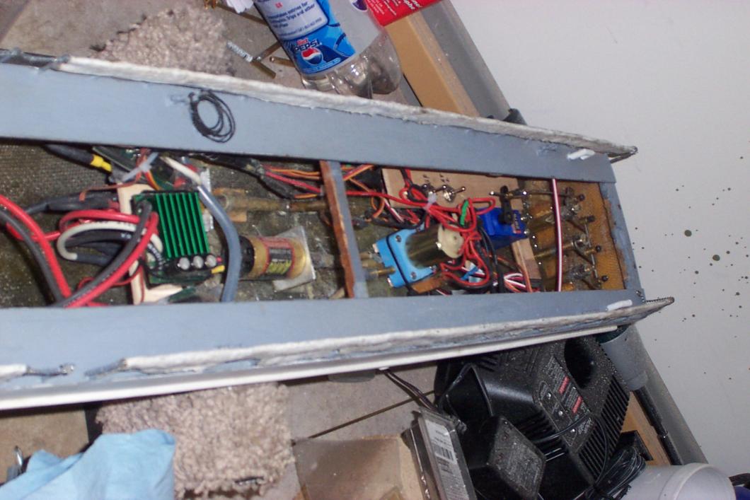

You can install the air tank, fill valve, and air distribution valve where ever it is most convenient for you. Attach the air lines and check that everything works.
Glue a magnet to the outside of the plastic tube so that it shuts the motor off while the torpedo is in the tube and where it won’t be seen. Slide the torpedo into the tube so that the 3/32 tube slides into the propeller shaft and rotate it so the magnet keeps the motor shut off. Fill the air tank and test the operation.
Don’t be surprised if it takes a lot of pressure to launch them. They are not the lightest of torpedoes.
Have fun and amaze your fellow boaters, just don’t sink them!
Launching Method
