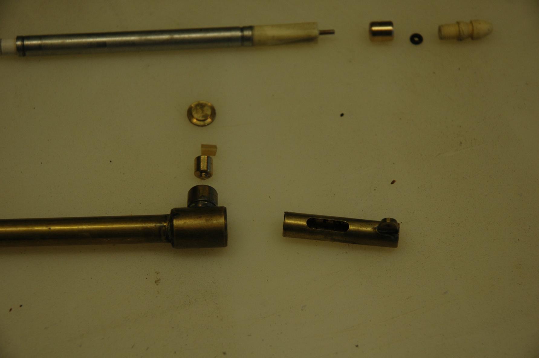

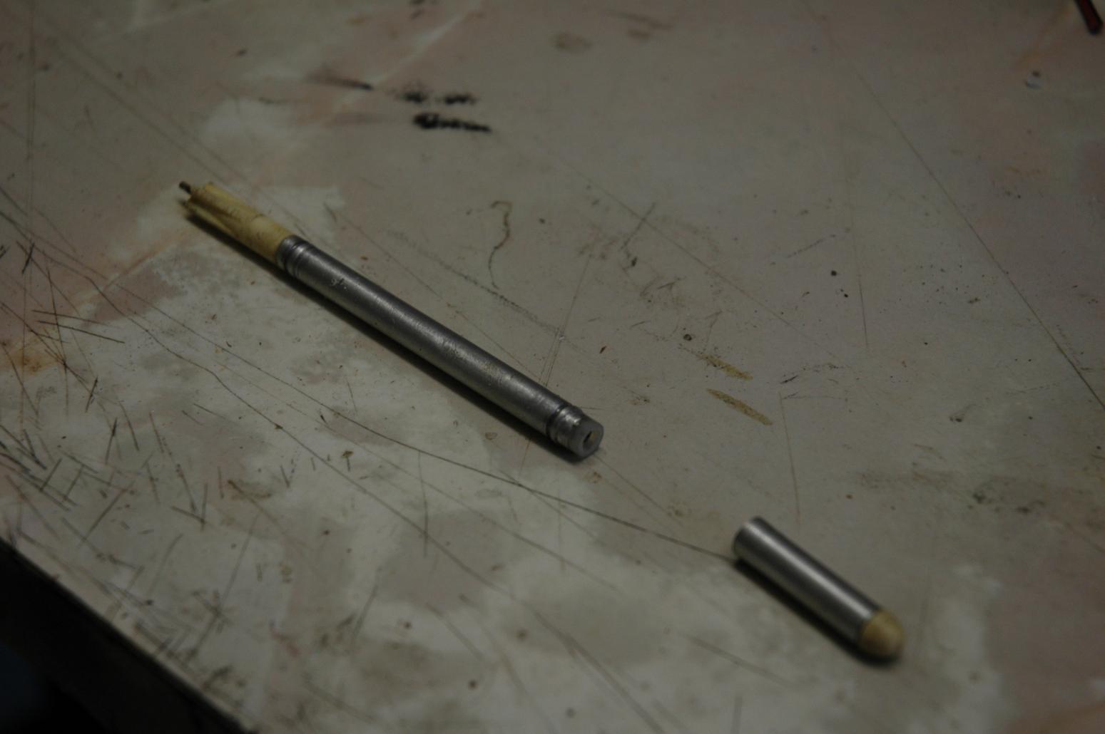

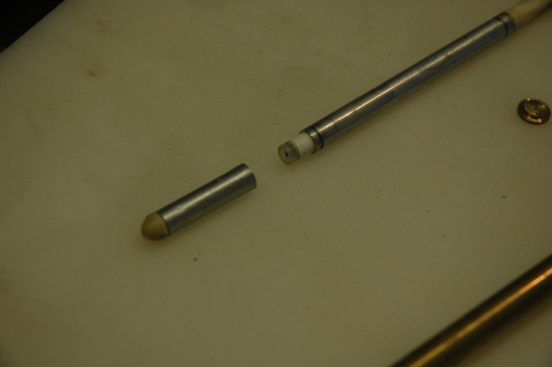

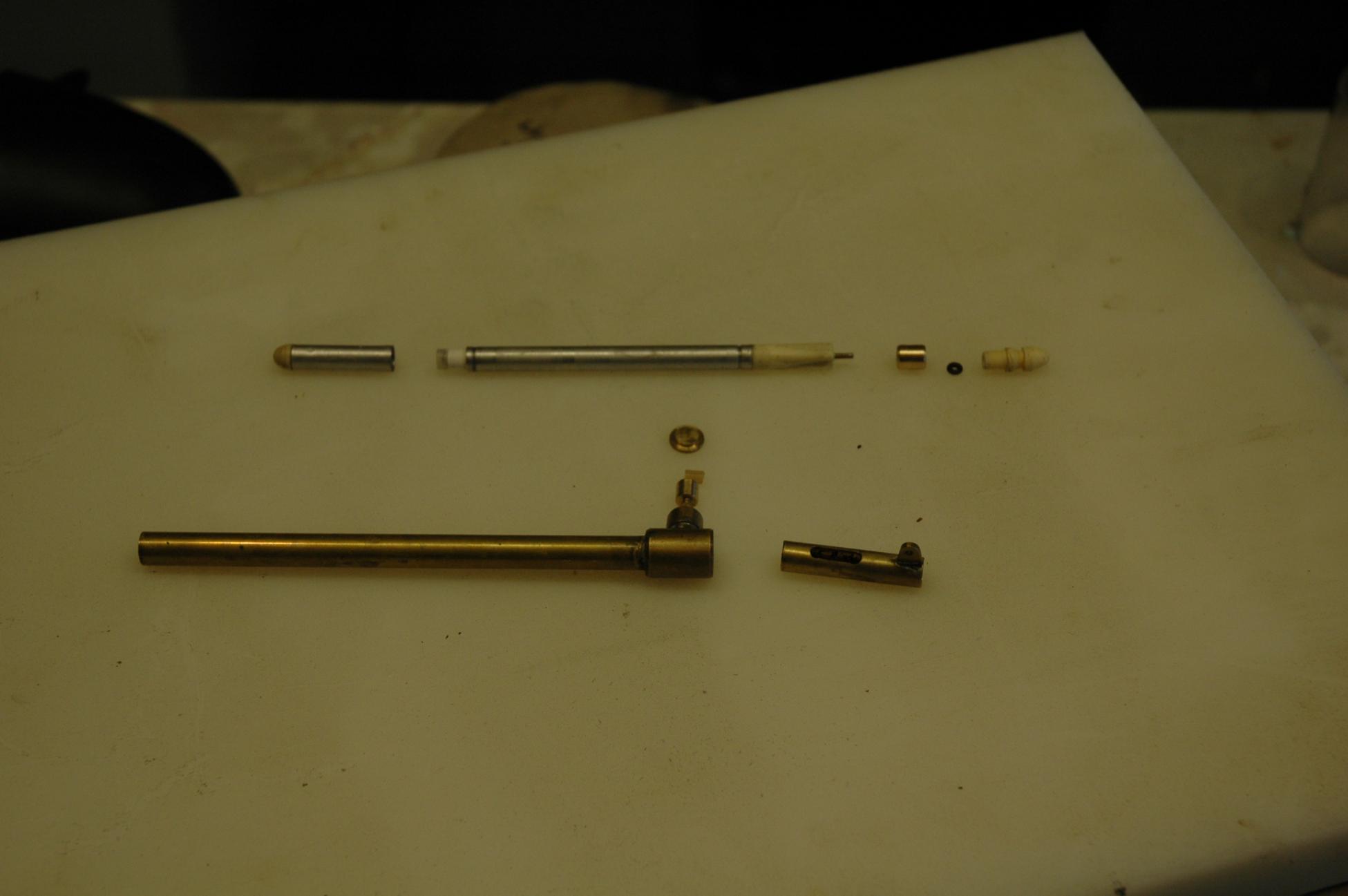

      As promised chaps, photos of my torpedoes, the ones shown are 1/72nd(ish) scale for my revell Gato, they don't hold a lot of gas but will run for around 30 feet (700 yds to scale) but you can make them pretty much any size, I have put a couple on the Italeri S100 Snell boat but they are 1/35th so a fair bit bigger.
      Whats odd is that the range is about the same to scale (700 yds)
      I hope that this is enough to get someone to have a go-------sorry David if this is going to screw up sales.
