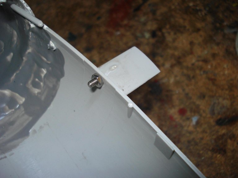

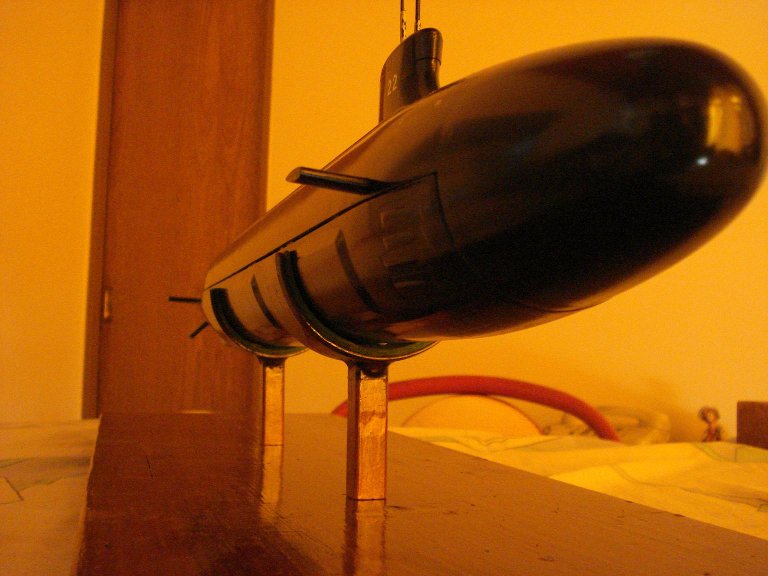

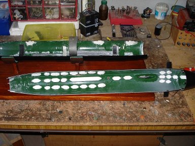

    The hull comes in two halves, upper and lower, which from now I’ll name them the “upper” and “lower” hulls, with the bow and stern sections in halves too. To ease the process of attach and detach the hull and to work in the interiors without room limitations, I glued the bow section to the upper hull and the stern section to the lower one.

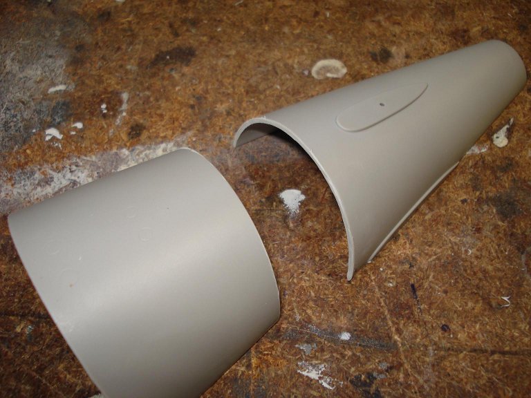

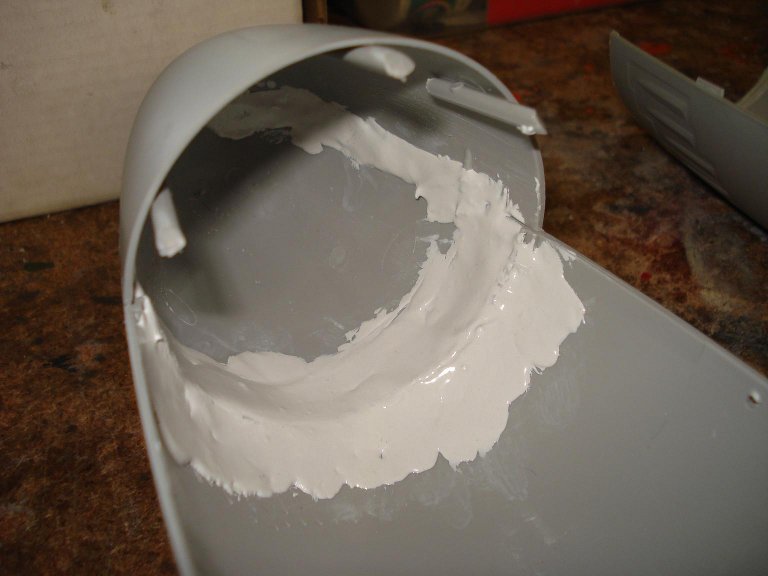

    A length of the stern section (from the upper half) was cut and glued directly the upper hull in order to have more room to work with the servo linkages. The adhesive used was that provided with the kit, but I added epoxy (two components) for reinforcement. I followed the advice of painting the epoxy adhesive once cured in order to protect it from the water. Maybe that wasn’t necessary, but I did it.
    The WTC is a 70mm external diameter acrylic cylinder, with just 64 mm of internal diameter. To accommodate it inside the hull, I glued three 2mm rubber strips to the lower hull, and a 80mm diameter acrylic section where a screw holds the upper hull in place.

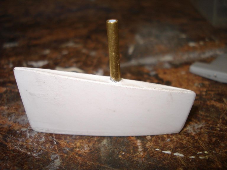

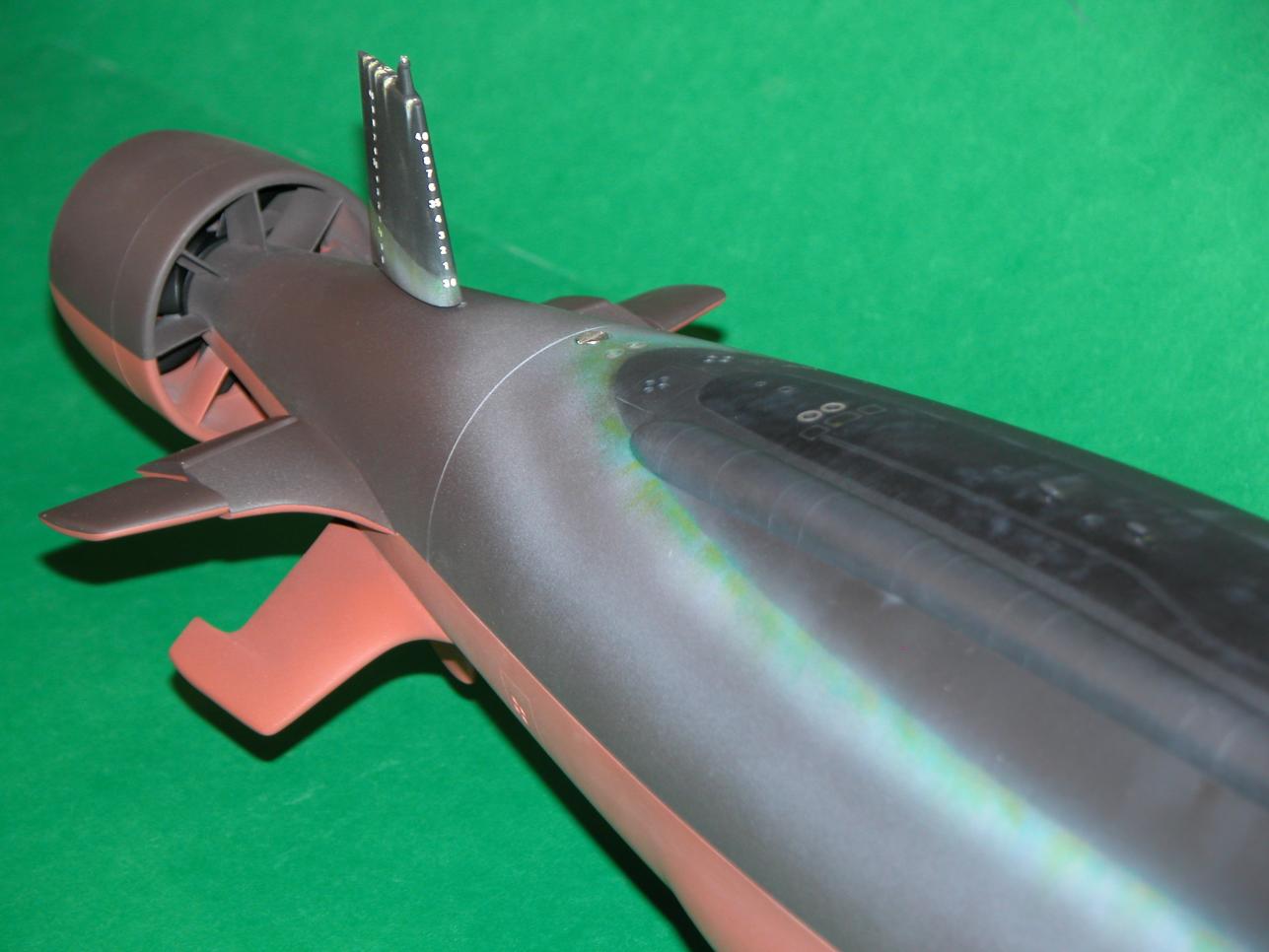

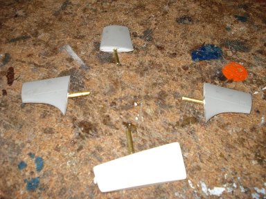

    The rudder and depth planes come in halves, which is fine because you just have to glue a 1/8” shaft between those halves and fill them with epoxy, that’s all. At the stern section, the model has two fixed planes which must be installed at a 45 degrees angle to the horizontal. As suggested by the construction guide they should be glued but I decided to fix them with screws just in case a replacement or repairing must be done.
    I discarded the lower rudder that comes with the kit; it simply doesn’t seem to work due to scale inefficiency, so I built another to double size in area from plastic.
    The bow planes are not operational in my model: I fix their position with screws as needed according with any inherent trend to dive or surface.

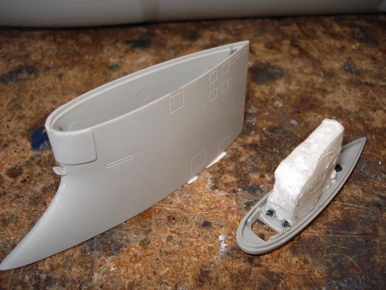

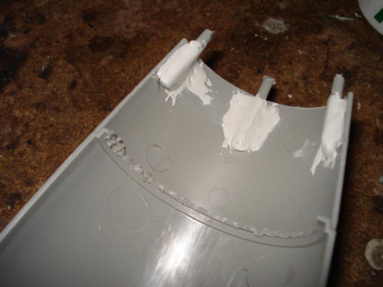

    The sail comes in two sections too, which I glued after adding some polystyrene foam as reserve buoyancy.

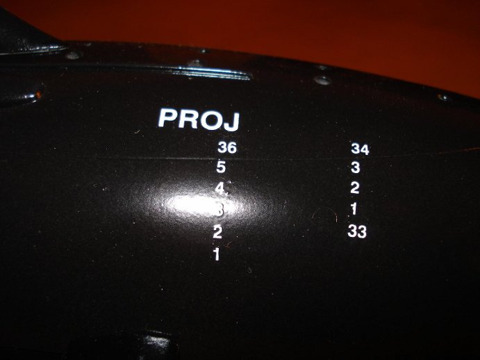

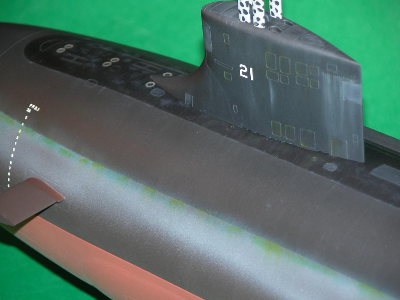

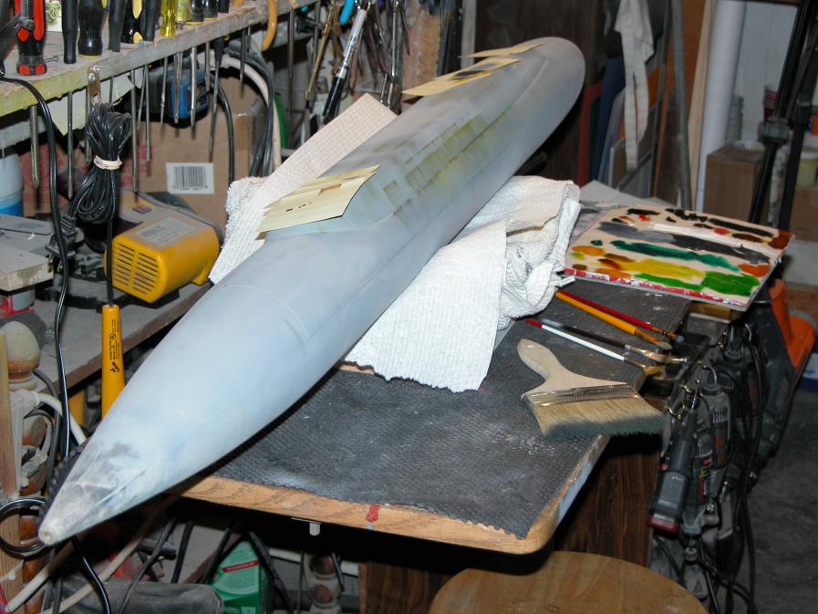

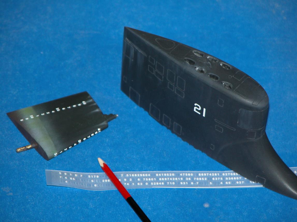

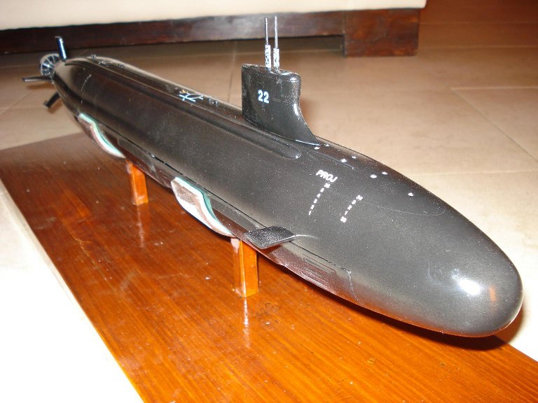

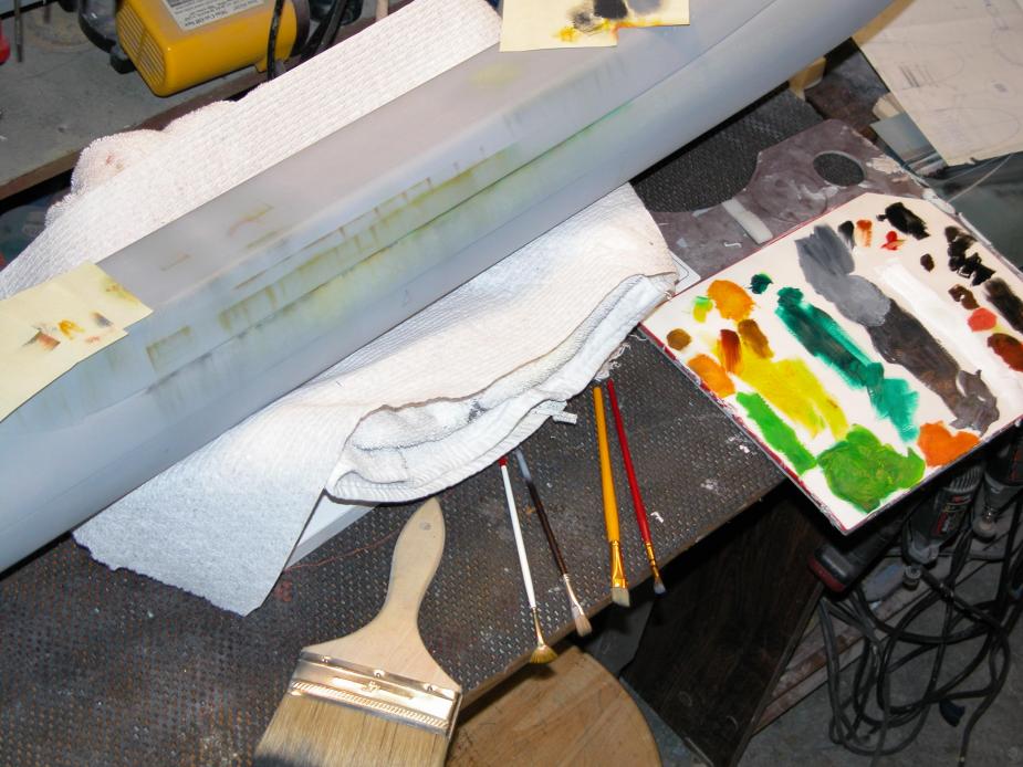

    Painting and decals
    As far as I know the SSN21 had the lower hull painting in antifouling red, but after the first shakedown it was painted completely black; the SSN22 and SSN23 were launched already painted black, so that was my choice. I used gloss black enamel thinned to 50% with spirit thinner and applied using airbrush. After the third layer had dried, I applied the decals. As for the “22” numerals, I had some adhesive numbers, incredibly at the proper size, kept by years, forgotten in a box.
    The final coat was an aerosol mate semi-gloss clear finish, to protect the paint and decals.

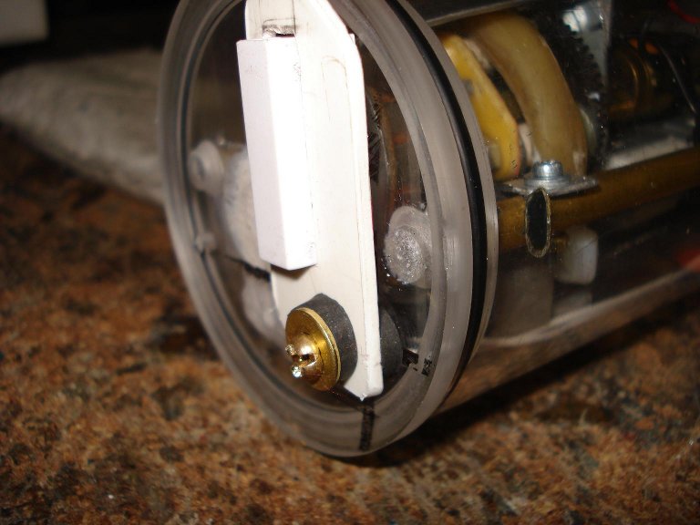

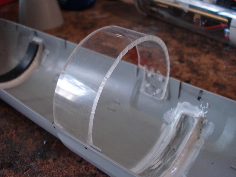

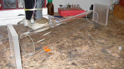

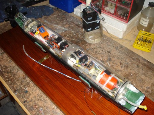

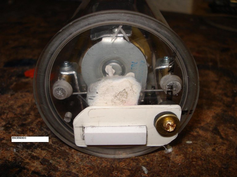

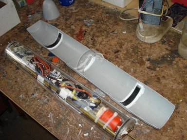

    The WTC, or Water Tight Cylinder
    As I told before, it’s an acrylic, 70mm (2.8 in.) in diameter, 42cm (16.5 in) long cylinder. That’s the greater size I could accommodate in the hull. The lids are two 12mm (0.4 in) thick acrylic sections which were turned in a lathe and shaped to fit in the cylinder, with a groove for installing the o-rings which seal the WTC. All the seals in my model are o-rings, a cheap and effective seal: servo linkages, propeller shaft and WTC lids.
    Two brass tubes screwed to one of the lids run along the cylinder hold all the components: servos, ESC (electronic speed controller), batteries, ballast system.

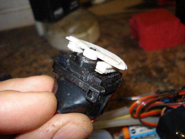

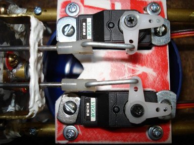

    Servo linkages

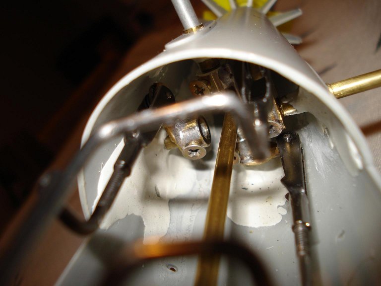

    I used 2mm stainless steel bicycle wheel spokes as pushrods, they have a screw thread at one end with connects with the metal clevis linked to the control planes. To connect them with the servos pushrods I used plated wheel collars. The sealing is provided by a 5.5mm o-ring (one for each pushrod), which has a 1.5mm inner diameter. I drilled two 2mm hole in the lid which I enlarged from the exterior to 4.8mm, this way providing passage for the pushrods and at the same time housing for the o-rings.
    I had to bend the spokes at 90 degrees accordingly because at the stern section the two (rudder and depth) planes and the shaft meet at one point, needless to say you can’t link the two rudders (upper and lower) or the depth planes with a single shaft, so every pushrod has to link two shafts. I had to measure everything twice and three times to make sure everything run fine and with proper geometry.

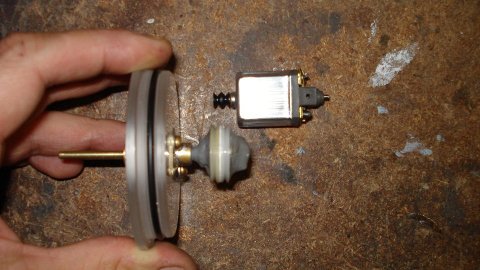

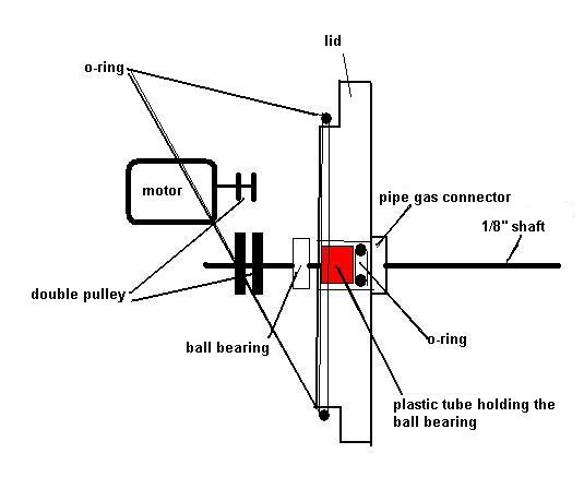

    After many trial-and-error cycles I came to install a 280 type motor engaged to the prop shaft with double thin o-rings working as transmission belts, to a 3:1 ratio. The pulleys come from gutted CD-ROM devices.

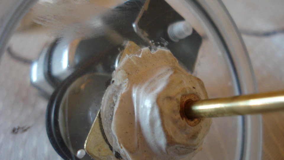

    To seal the shaft I used a special type of fluoropolymer elastomer o-ring, the shaft is a 1/8 brass tube, the o-ring has a smaller size in order to seal the shaft when stationary as well as when rotating. The shaft seal is installed inside a ¼” pipe gas connector, glued to the lid with epoxy. A small plastic tube holds the o-ring in place.
    The coupling between that shaft and that of the propeller is a length of silicone hose. Simple and effective.

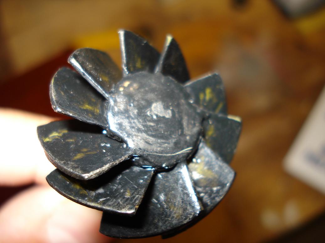

    The prop that comes with the kit is just for display, it doesn’t even have any angle of attack. I discarded it. Instead, I modified two 55mm diameter toy props to create a 30mm, 10 blades propeller, I don’t know whether it is similar or not to the real one, submarines prop designs are a well kept secret. But it works!

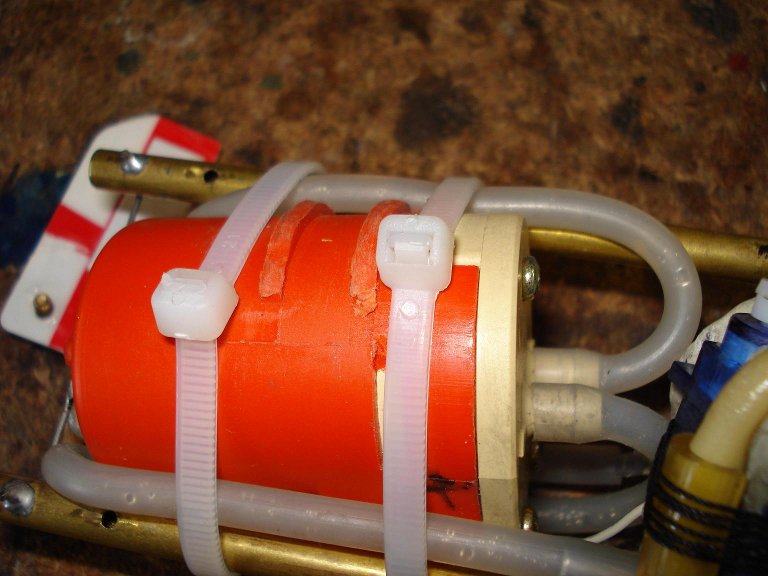

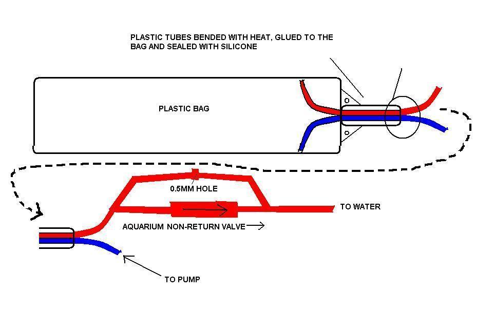

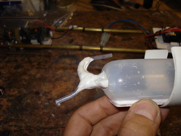

    My system works this way: to dive, an electric geared water pump (those used for windscreen wiper systems) fills a plastic bag, this is one of those used for intravenous infusion in hospitals, 100cc (cubic centimeters) in this case, and the air escapes from it through a small hole (0.5mm), like a spray nozzle, drilled through a piece of epoxy, connected to a plastic hose. In parallel with this, an aquarium non-return valve works as a bypass in order to alleviate the pressure build up inside the bag once it is full of water if the pump keeps on running. To surface, the pump is run in the opposite direction. You wonder whether it works or not underwater because as water is pumped out from the bag, more water enters through the hose to fill the vacuum inside the bag, but that doesn’t happen, because the small hole prevents water from entering the bag, at least in the same quantity as it exits (through 3/16 brass tubes). That simple. Once the sail surfaces the hose picks air again, and the pump empties the bag. It takes no more then 15 seconds to make the sub disappear under the waves.
    The system resembles a snort, but I don’t need to surface and take air to blow the ballast, as in snort systems, because as the bag is flexible (but not elastic!) it collapses due to the vacuum inside created when “blowing the tanks”.
    This is a homemade ballast system, and I spent just a few dollars, maybe less then $50 building it.

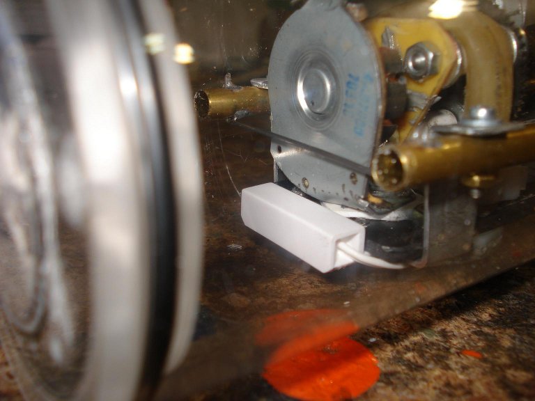

    Fail safe system
    You simple shouldn’t build a submarine with static ballast system without a fail safe, i.e., a way to make it surface again in case of signal loss. Well, I did it and I ended diving for my sub the first time I took it to the lake. Thanks God it was summer. I will never forget those twenty minutes looking for it at more then 6 feet deep of water. At least the WTC and the seals proved to work fine.
    One of our members is very skilled in electronics and he managed to program a PIC to send the servo the preset signal in case of signal loss. I just had to build the printed board and solder some discrete components. Now I dive the sub without worry: in case of signal loss (I loved to turn the transmitter off and test the system!), it gently returns to the surface.

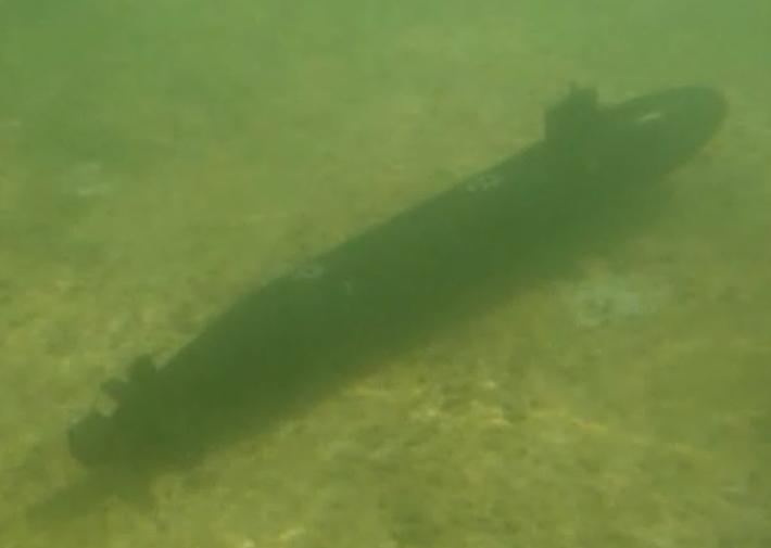

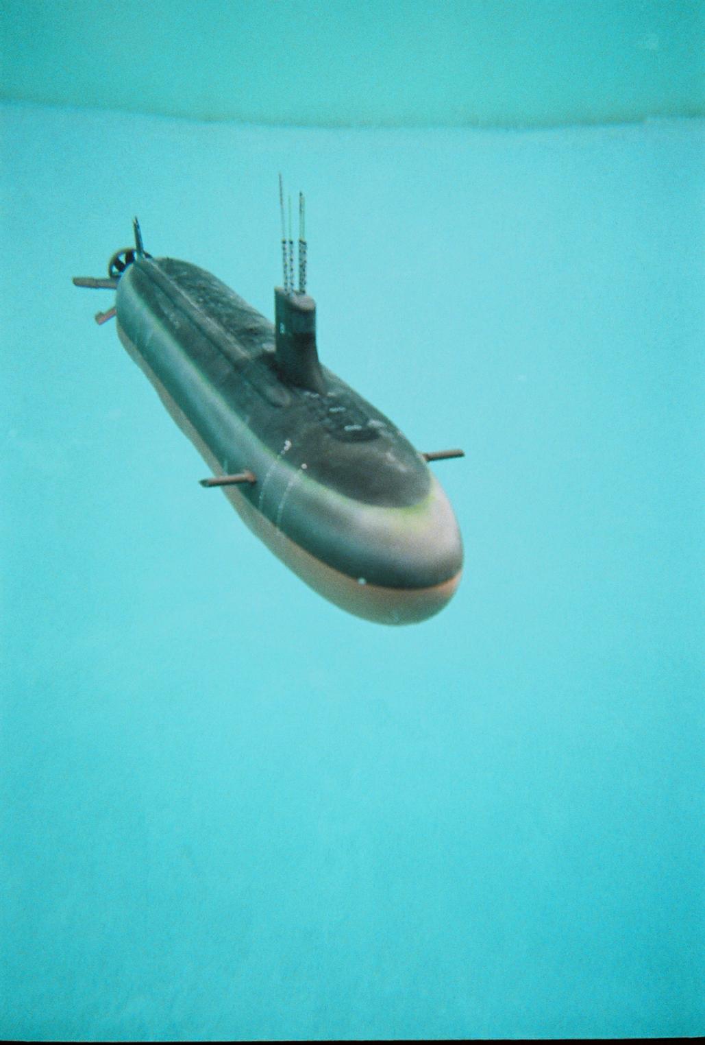

    After 7 months of work since I opened the kit box, I took it to a pond near home (in the province of Buenos Aires) and to my surprise, it reacted well to every input. The ballast system works fine, at least at 4ft deep (no deeper waters available here). Not a single drop of water inside the WTC, all the seals work fine. The depth planes have descent diving authority. Surfaced, it has a poor turning radius but this is a known issue with this kind of submarines, designed to spend most of their operational live underwater. Once submerged, not only the rudders gain turning authority but also the speed increases, due to the hydrodynamic shape of the hull.

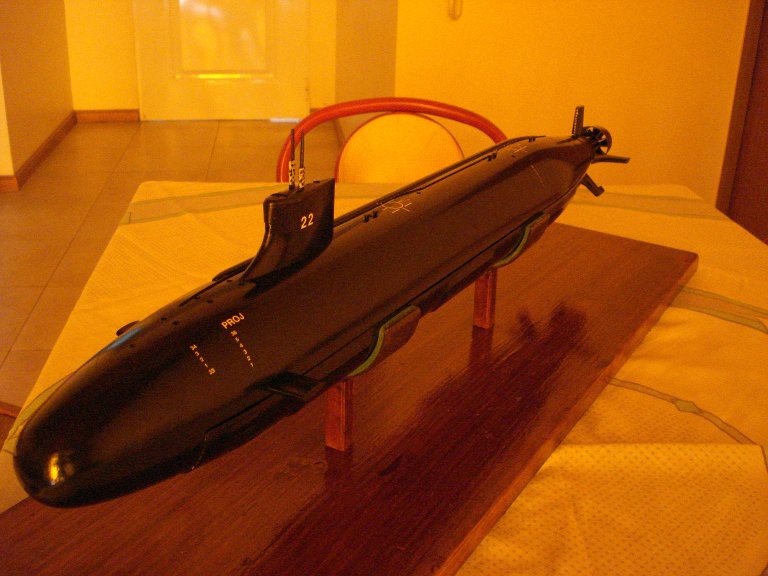

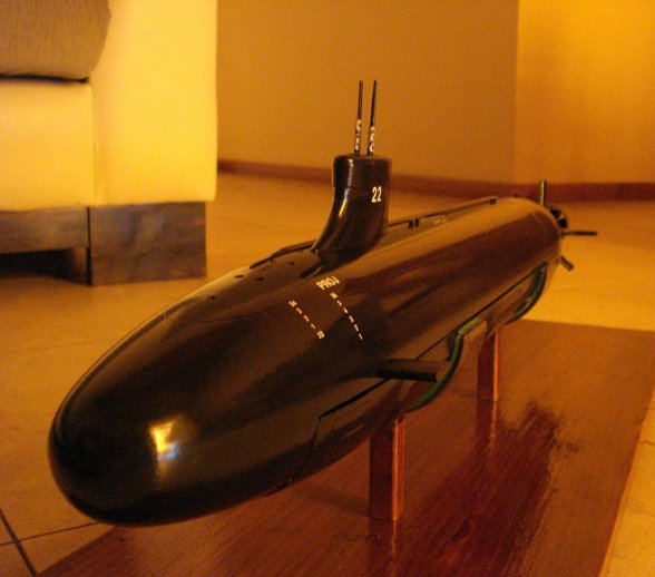

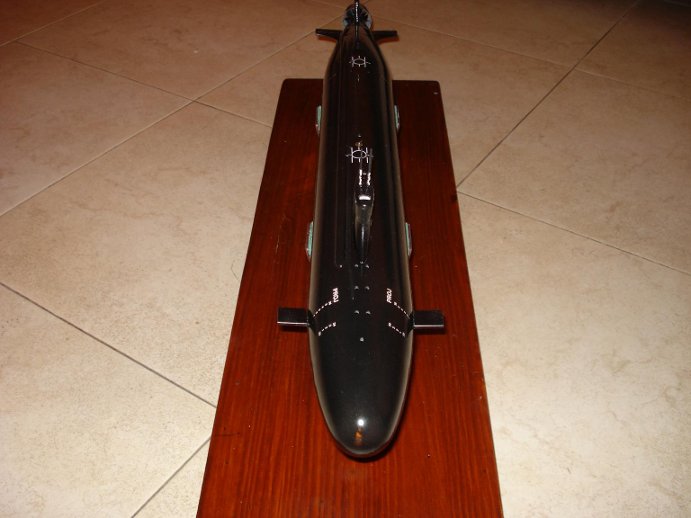

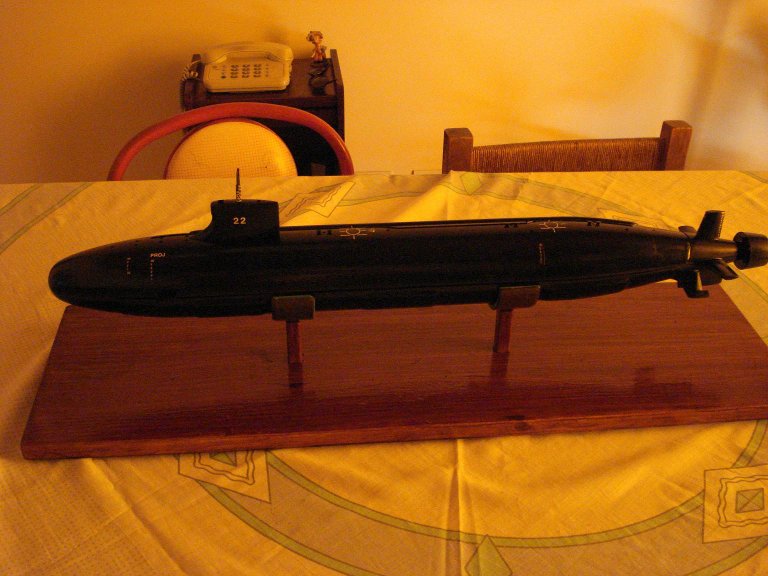

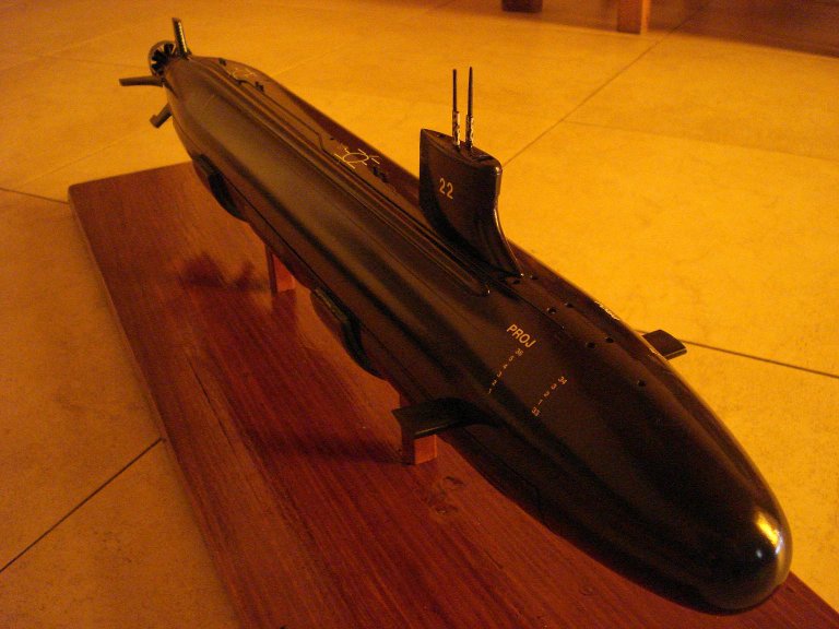

    SS01 L The finished model, SSN22 USS Connecticut, seawolf class attack submarine, rests in dry dock.

    SS03 S A section of the upper stern hull is cut away…
    SS04 S …then glued to the upper hull.
    SS05 S Once assembled, the bow is glued to the upper hull.

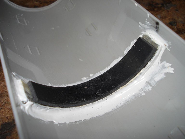

    SS06 M This acrylic semicircle holds the WTC in place. A screw holds the upper hull.
    SS07 S Belt strips prevent the WTC from slipping.
    SS08 L The lower hull besides the finished WTC.
    SS09 L The WTC installed in the lower hull.
    SS10 M The acrylic cylinder. The lids will be made by turning the two 12mm thick acrylic squares on a lathe.
    SS11 M The control planes with their shafts.
    SS12 S The bow planes are attached using screws that let adjust their position prior to sail.
    SS13 S The oversized lower rudder gives plenty of steering authority.

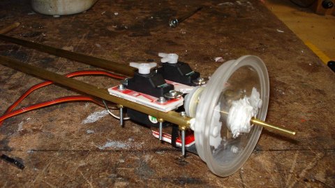

    SS14 M Two servos control the rudders and depth planes.
    SS15 M Servo linkages. They protrude from the lid and are attached to the planes.
    SS16 M The servo linkages, properly bended to allow for complete movements without interference between them and the prop shaft.
    SS17 L Diagram showing how the running hardware, seal included, is installed.
    SS18 M The transmission is provided by double pulleys and two o-rings as belts.
    SS19 S The bushing that holds the prop shaft is glued to the lid with epoxy.
    SS20 M The 280 motor is installed under the servos.
    SS21 S The 10 bladed prop is made from two plastic 5 blades props.

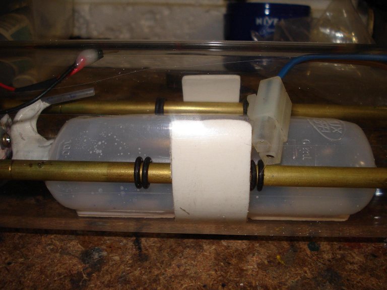

    SS22 L The ballast tank: a 100cc saline solution plastic bag.
    SS23 L Two bended plastic tubes enter the bag: one connected to the pump, the other to the snort via a hose.
    SS24 S The 12V electric geared water pump. Centrifugal pumps are not reversible, so cannot be used here.

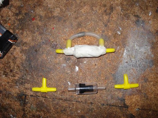

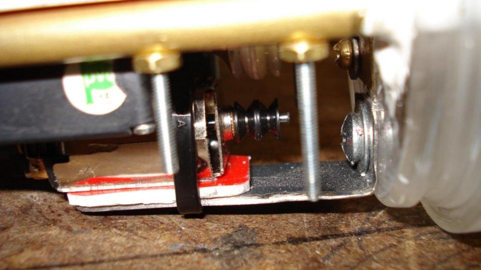

    SS25 M Above, the bypass; below, its components, the non-return aquarium between two aquarium hose connectors.
    SS26 M The pump is operated both directions by two micro switches attached to a micro servo.

    SS28 S Magnetic switch in OFF position.
    SS29 S Magnetic switch in ON position.
    SS30 M Inside the WTC, the reed switch. It works by proximity with the magnetic switch, attached to the lid by a screw

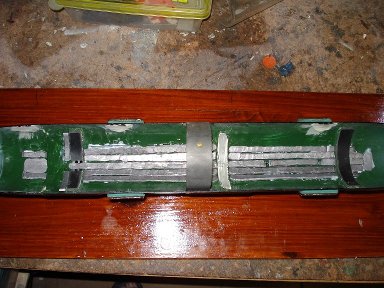

    SS31 M Fixed ballast –lead strips glued to the lower hull.
    SS32 M Reserve buoyancy glued to the upper hull.

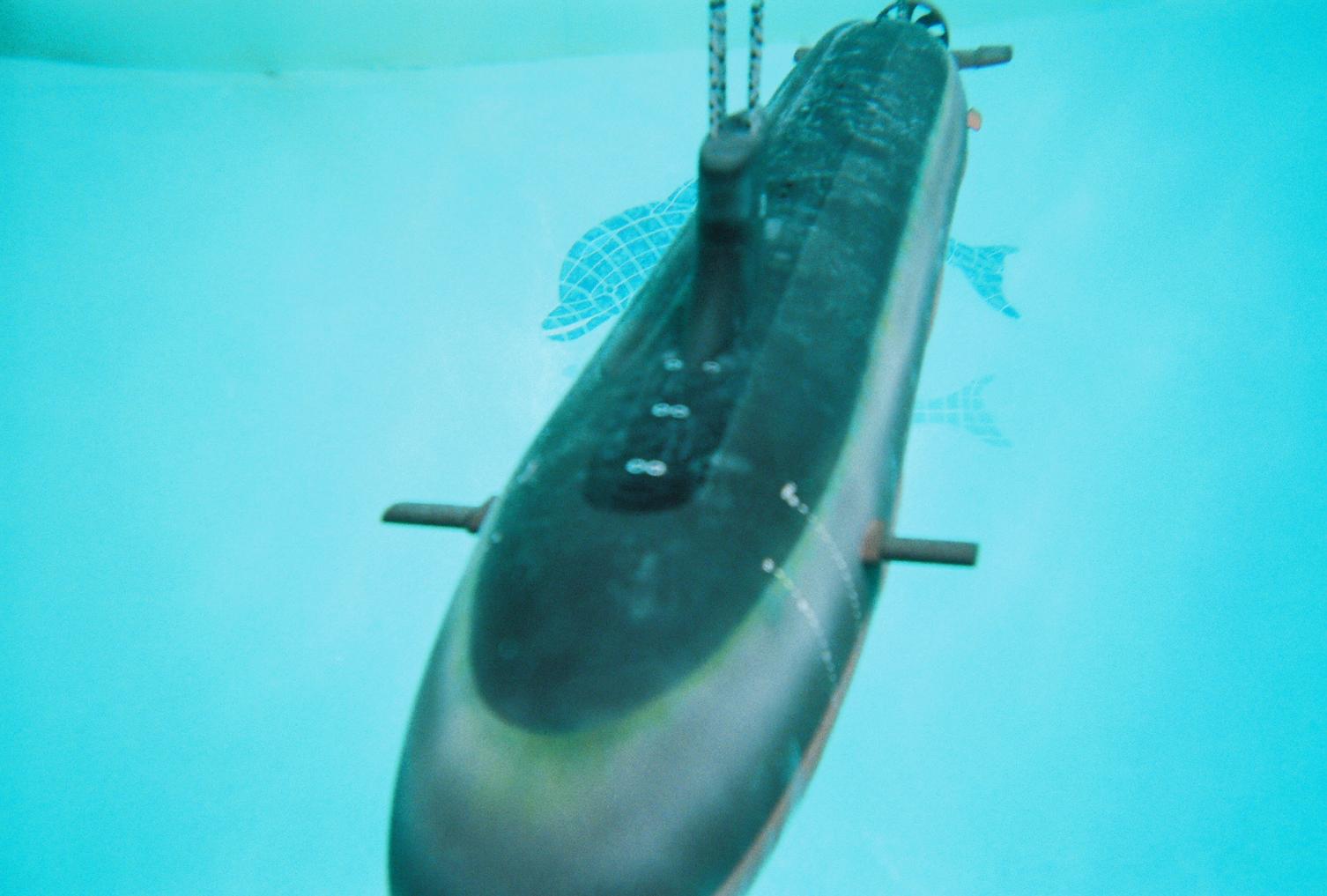

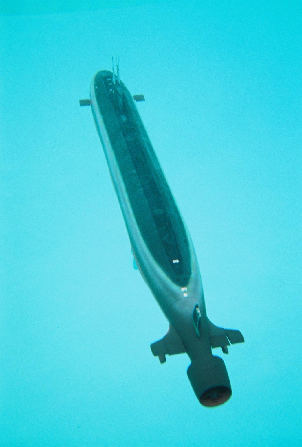

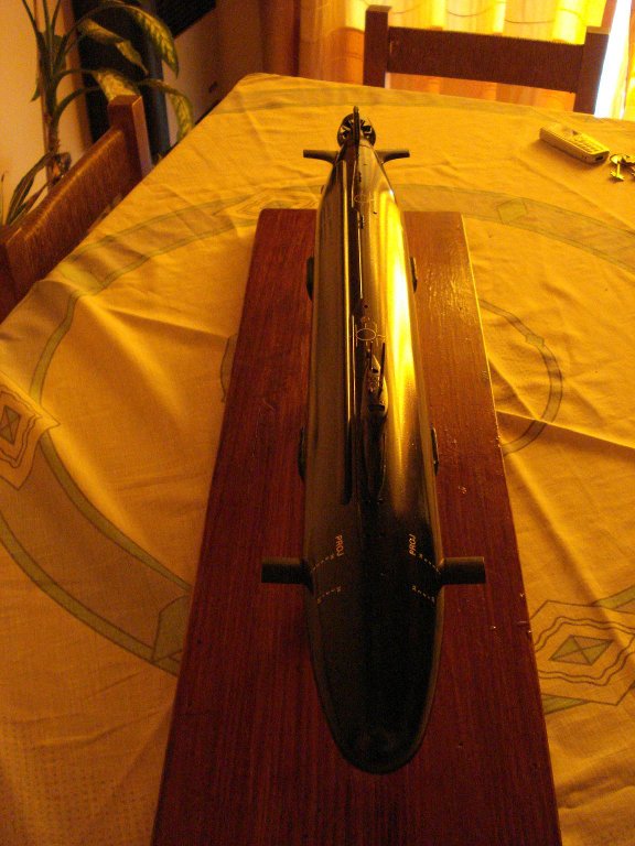

    SS34 L The finished SSN22, peacefully bobbing in the pond.
    SS35 L Bottoming at 4ft deep in the pond, possible thanks to the ballast system and negative buoyancy (and the fail-safe system!).

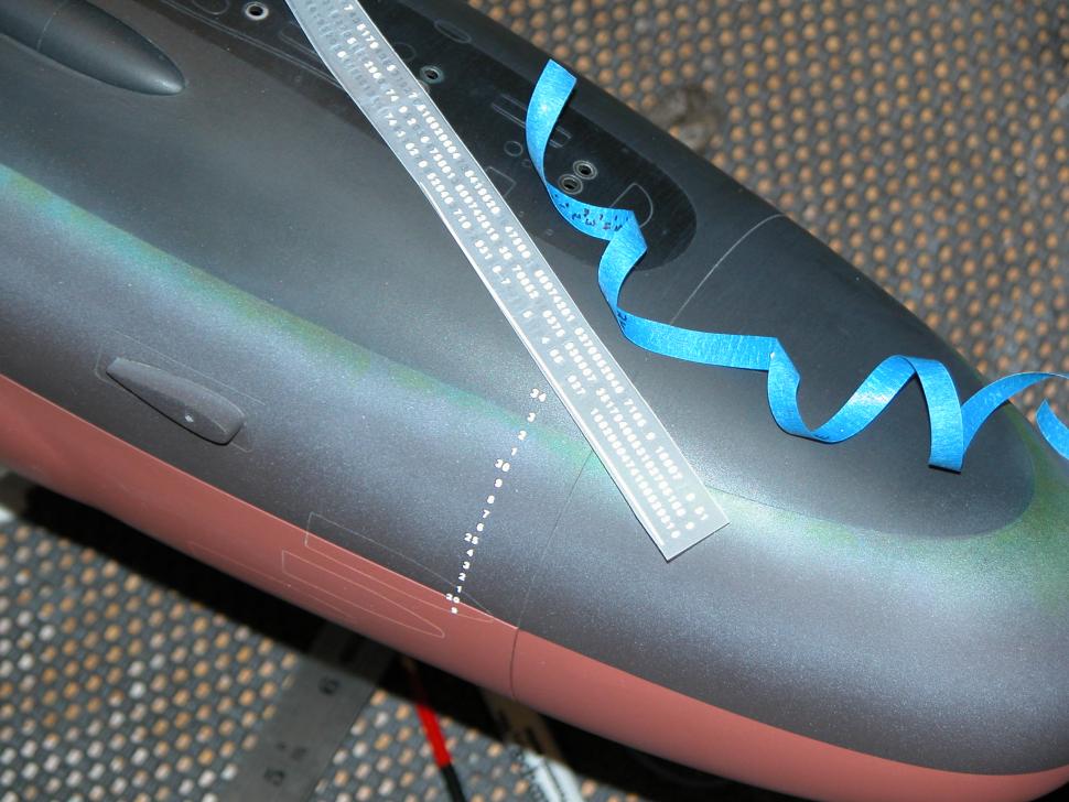

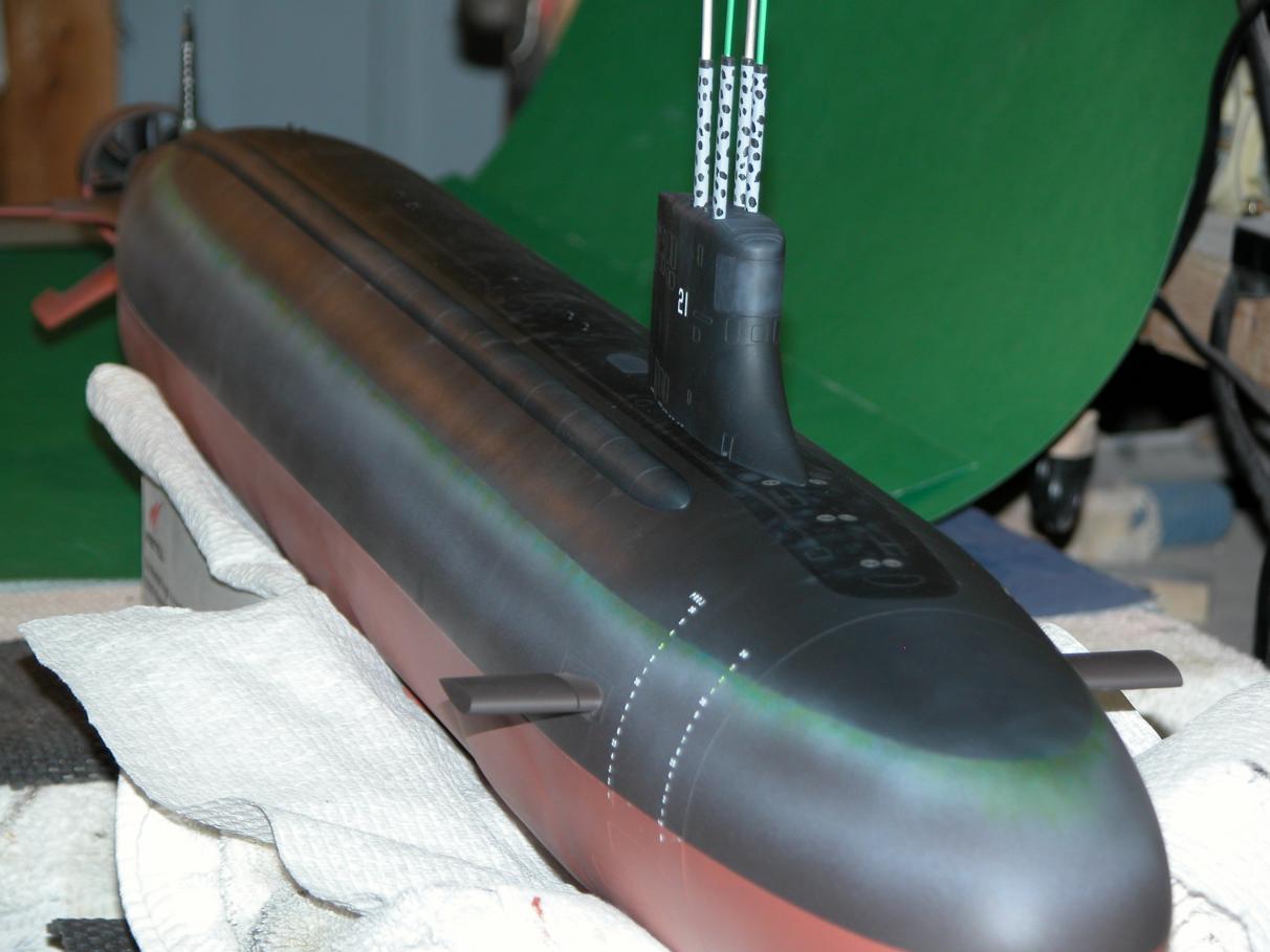

    The finish on your boat is a bit ratty -- likely handling and collision caused. Slap on a better paint job, you got plenty of time. Read my article on painting and weathering -- they'll help you a lot.
    Innovative stuff on the ballast system you came up with. No arguing with success -- and you've avoided solenoids and other wasters of space and electrical current. Excellent presentation: good shots and complete and straight-forward text.
    Repaint that thing!

      Thanks for your advice.
      First, not bad for a first. Second, I don't have that plenty of time so no new paint in the near future.
      I added some new pics, it doesn't look that bad. Did the Navy let you visit the SSN22 in drydock to see its real paint scheme?
      I knew in advance I don't have any chance of earning any prize, as you'll ore probable consider the "Merriman-like systems". And so far, I got some negative critics about my system, all based in speculation because the only working sub with my system is precisely mine.
      I just wanted to show other modellers my project.
      Regards
      Robert
        • 14013
        Don't be so **** touchy!
        If anything I'll award more points for a home-made system than a store bought. Buying my **** and sticking it in a kit any idiot can do. You've taken your own road and have produced a system (the ballast sub-system is noteworthy) that meets the demands of the submarine.
        I don't kiss ass, pal. The above was my usual objective, to the point, analysis. If your WTC sucked, I would have said so. What you've presented so far is a mixed bag: so-so paint job, very good engineering.
        Make the time, damit! Re-paint that thing. here are some suggestions as to how to do it
