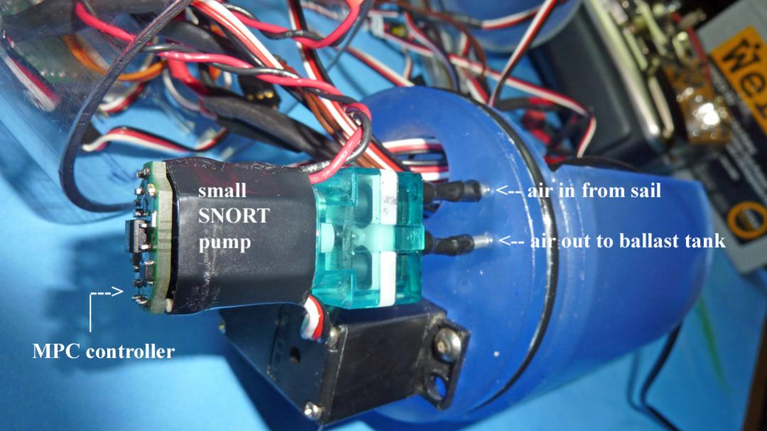

    I recently added a SNORT system to the sub I use as a test bed for ideas - a Small World Models Blueback in 1/96 scale. Here are the pictures:
    The pump and manifold on the dry side of the ballast tank bulkhead...Click image for larger version

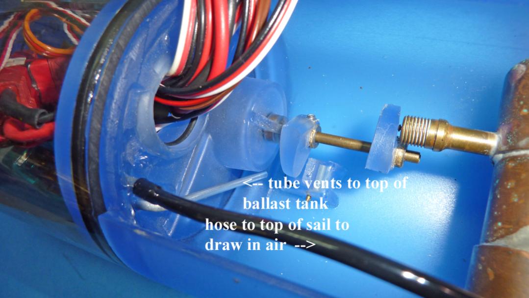

    And here is the wet side where the air is vented to the top of the ballast tank and is also drawn in from an opening in the sail...Click image for larger version
