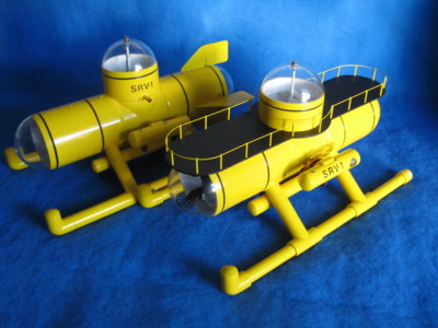

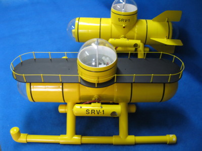

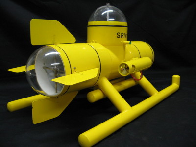

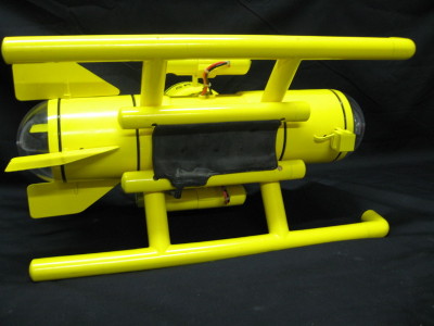

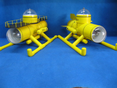

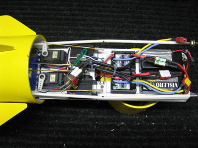

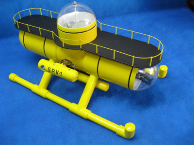

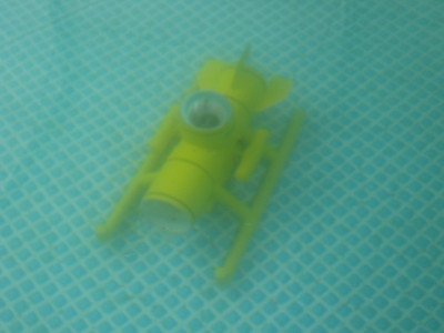

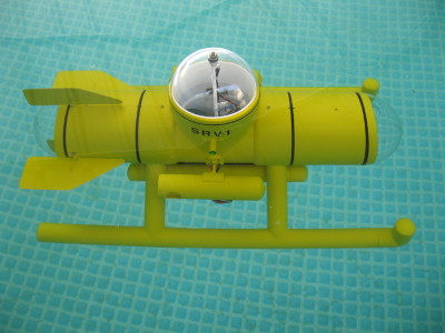

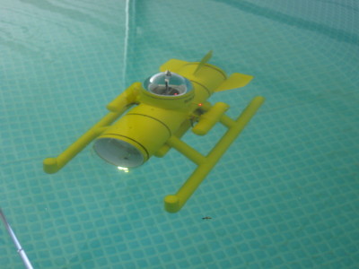

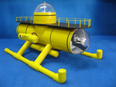

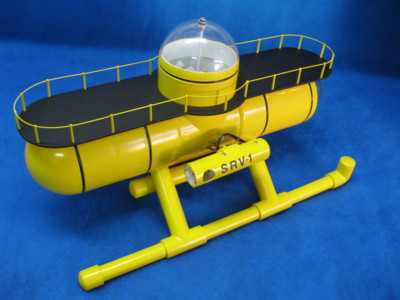

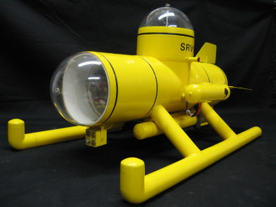

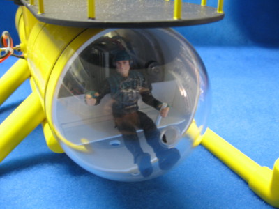

    About a year ago, I was waiting on parts for one of my other subs. So I got an idea to build a home made sub. This is what I came up with. Here are a few things I put in it. I started out with some 4" PVC and went to work. I put two tilting power pods on it with 385 motor in each one. It has two viper 10 ESC in it and two 11.1 Lipo battires and a dual ESC Mixer. It has running lights, a strob light and a LED flood light. I put a RCABS in it as a back up with a dual E switch with a clippard and a air pump. I can dynamic dive it with no forward motion and with the power steering , it will turn on a dime. Well here are some pictures of it. Hope you like them Check out my video of the sub on youtube ( RC Sub in a box ) Here are some updated pictures of my creation. LOOK no tail fins
