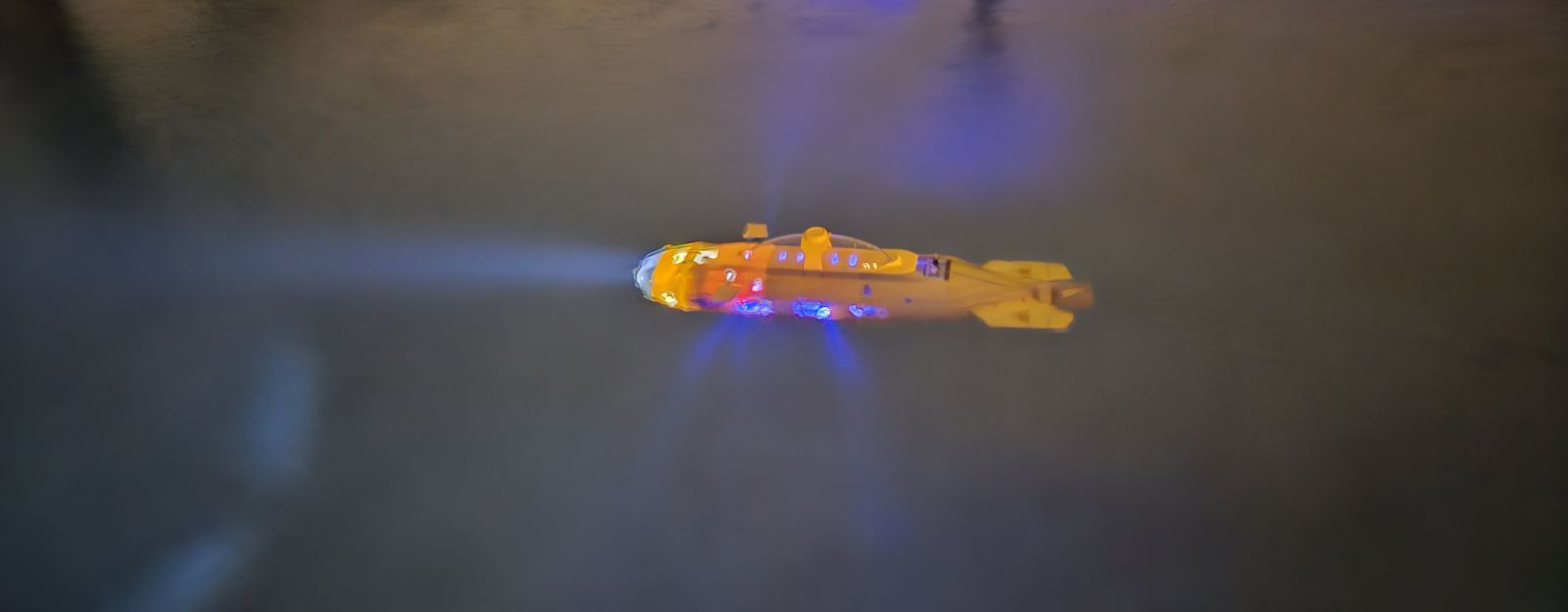

        Here is one I rebuild for someone. One picture is the sub as it was getting dark and the other is the Neptune 10 feet at the bottom of pool holding station. Running at 75mhz

            Here is my own person Neptune sub. Yes I know it looks like a Seawolf, but I gutted this Neptune and replaced the parts with Seawolf parts and added the bigger prop with a brushless motor, Lipo battery.
            Thanks, well not doing that great since I'm having trouble fitting everything back into the tube.
            Your pictures look great. The great night shot makes me rethink my ideas for customization. Maybe all those windows are ok if you put in some illumination. I'm thinking LED chain. Hmm.

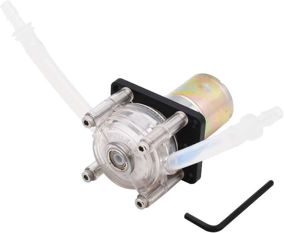

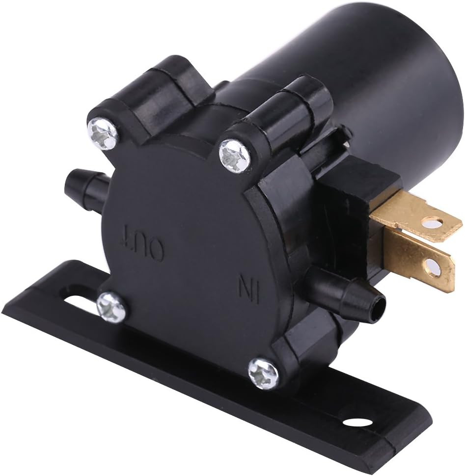

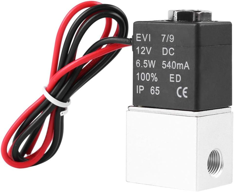

                Here are two of the replacement pumps setups i have used in the Neptune. Got the all the stuff off Amazon. Also you don't need to get this pump, a smaller pump will do. It will just take longer to dive and surface.
                Intillab 12V DC DIY Peristaltic Liquid Pump:

                Keenso 12v Windshield Washer Pump and 2 Way Normally Closed DC 12V Electric Solenoid Air Valve 1/4" NP:
                Click image for larger version  Name:	61JCUMjp2hL._AC_SL1001_.jpg Views:	0 Size:	78.3 KB ID:	182856 Click image for larger version  Name:	512cG1OXcrL._AC_SL1000_.jpg Views:	0 Size:	89.5 KB ID:	182855
                Also if the Pump controller is bad and I am using 75mhz, or for people in Europe 40mhz. I use a Brush motor speed controller to control the pump with one of Bobs BLM - Battery Link Monitors connected to the receiver and pump, so if I lose signal it take control of the pump ESC and blows the ballast out bringing the sub to the Surface. You just need make sure when diving to stop the pump once you get the the point where the Neptune can dive using the dive planes. Its not a big deal
                  Other people have used this stuff too.
                  Great info, many thanks.
