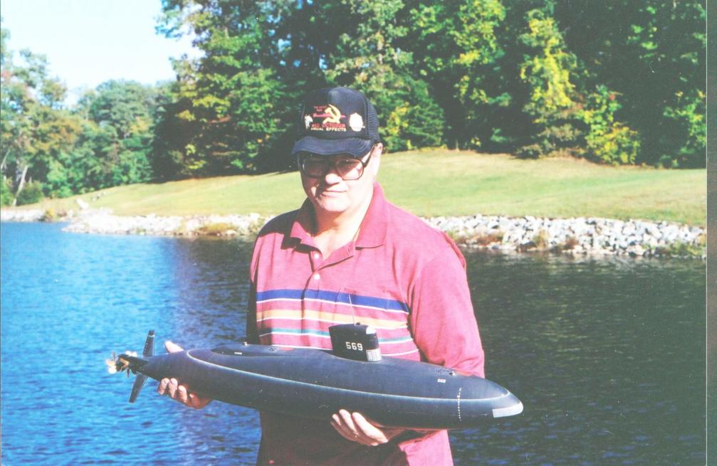

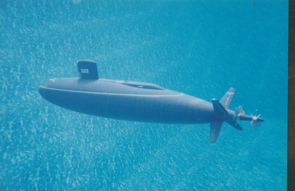

      Been done, kinda. It's called the ALBACORE, phase-4. Not a proper pump-jet, but did feature the bit more efficient counter-rotating propeller (which, like a pump-jet, works to recover much of the swirl energy lost with a single propeller).
      My friend, Kevin Rimrodt, and I did a Y-tail conversion of a 1/96 SKIPJACK, as well as a radically new type of sail. That was about 20 years ago -- we've yet to get it into the water.

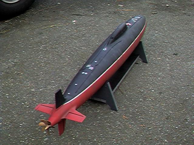

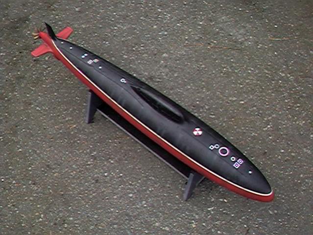

              Guess what I found in my old e-mails. These were given to me by Greg Sharpe in 2005. It's his scratchbuilt Russian Beluga class SSK. He used a 1/96 Skipjack hull.
                Can you show us how did you duplicate the counter-rotating propeller mechanism?
                  • 14012
                  Don't have any shots of that. One motor drove the inner shaft, a second motor drove the outer shaft through a gear drive. That simple -- two un-coupled motors, each driving one of the two concentric shafts. Dirt simple. And the propellers naturally load-match to produce a zero net torque on the vehicle. Slick.
                    KISS. BTW, was the inner shaft a direct drive or geared?
                      • 14012
                      The inner shaft was direct drive, so was the outer -- in effect -- the two gears used to make up to the outer concentric shaft were of the same diameter.
                        How did the model perform with the contra-rotating set-up?
                          • 14012
                          scary fast
                          • Nuke Power
                            Banned
                            • 277
                            Did it out perform the skipjack?
                              • 14012
                              When I tried to get up to SKIPJACK speed the ALBACORE got too squirly for me to drive. No, never sustained a SKIPJACK flank bell with the ALBACORE, but it had the ass to do it.
