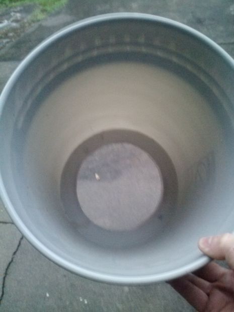

          It depends on several factors. Most fish finder sonars dont show actual fish on the monitor. Just graffix of a fish. Some dont even show the size of the fish. Sonar is a radio signal that bounces back and is interpilated to a screen on the monitor. The more expensive fish finders can interpilate the signal to define various sizes, but not the actual fish. The icon on the screen just shows a generic fish. I use fish finders almost every day since I am a Florida Keys fishing guide. The signal you get off the bottom will not define the shape of the boat, but a line graph. The boat may not be sitting upright. Your best bet is to get wet or get a camera. I use the camera all the time to check out under the boat to see weather or not its worth the effort to stop and fish after we get the primary signal of active fish suspended between the boat and the bottom. Also for dropping the anchor without hanging up on a coralhead. Its a big time fine around here in the sanctuary. I used one to find an anglers cell fone that fell out of his pocket not too long ago. We were in about only 40 ft of water, and the camer goes out about 100ft. One inexpensive alternative would be a view box. A plywood box with handels and a glass bottom, like a big dive mask. A piece of plexiglass and a 5 gal bucket and some RTV or silicone tub and tile seal. Just hang over the side of the boat and have a look. Click image for larger version
ID:	92084 commercial bathyscopes are available cheap but a clear plexiglass vegetable drawer out of a refrigerator works fine as well. And you can put it back after you find the boat. Click image for larger version
ID:	92085Click image for larger version

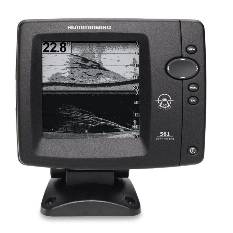

                          Look at the resolution on the screen. Specs says you could see your lure with this.
                          http://www.sportsmansguide.com/produ...inder?a=949334
                              You are still looking at an icon graphic and not actually seeing the oblect. How deep is the water in question? Visibility? Once you locate the boat, how are you going to get it up?
