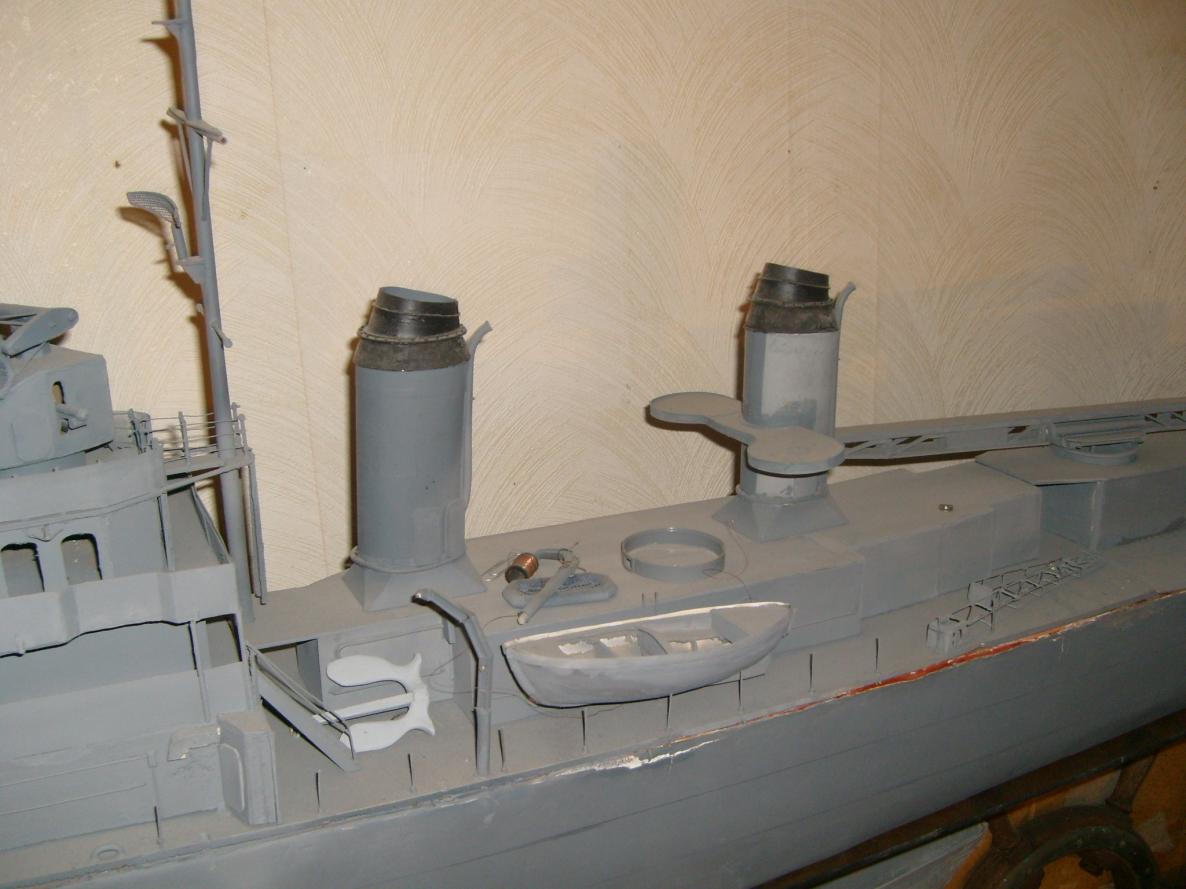

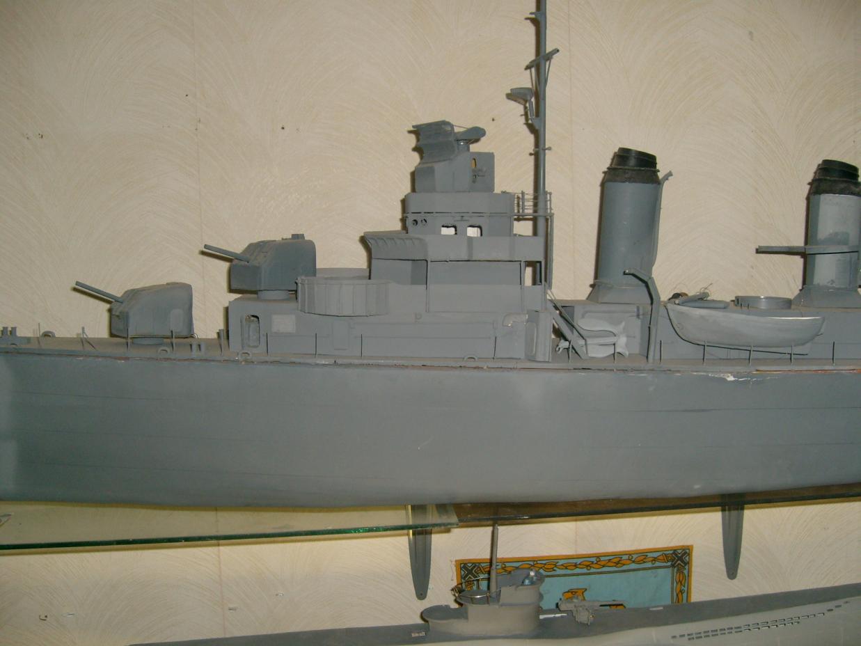

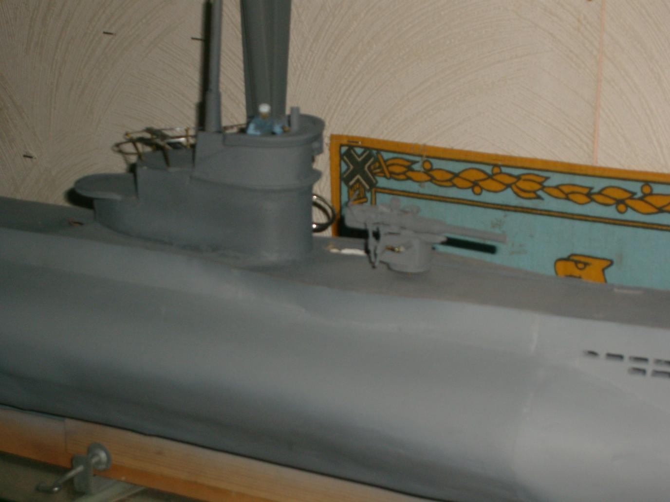

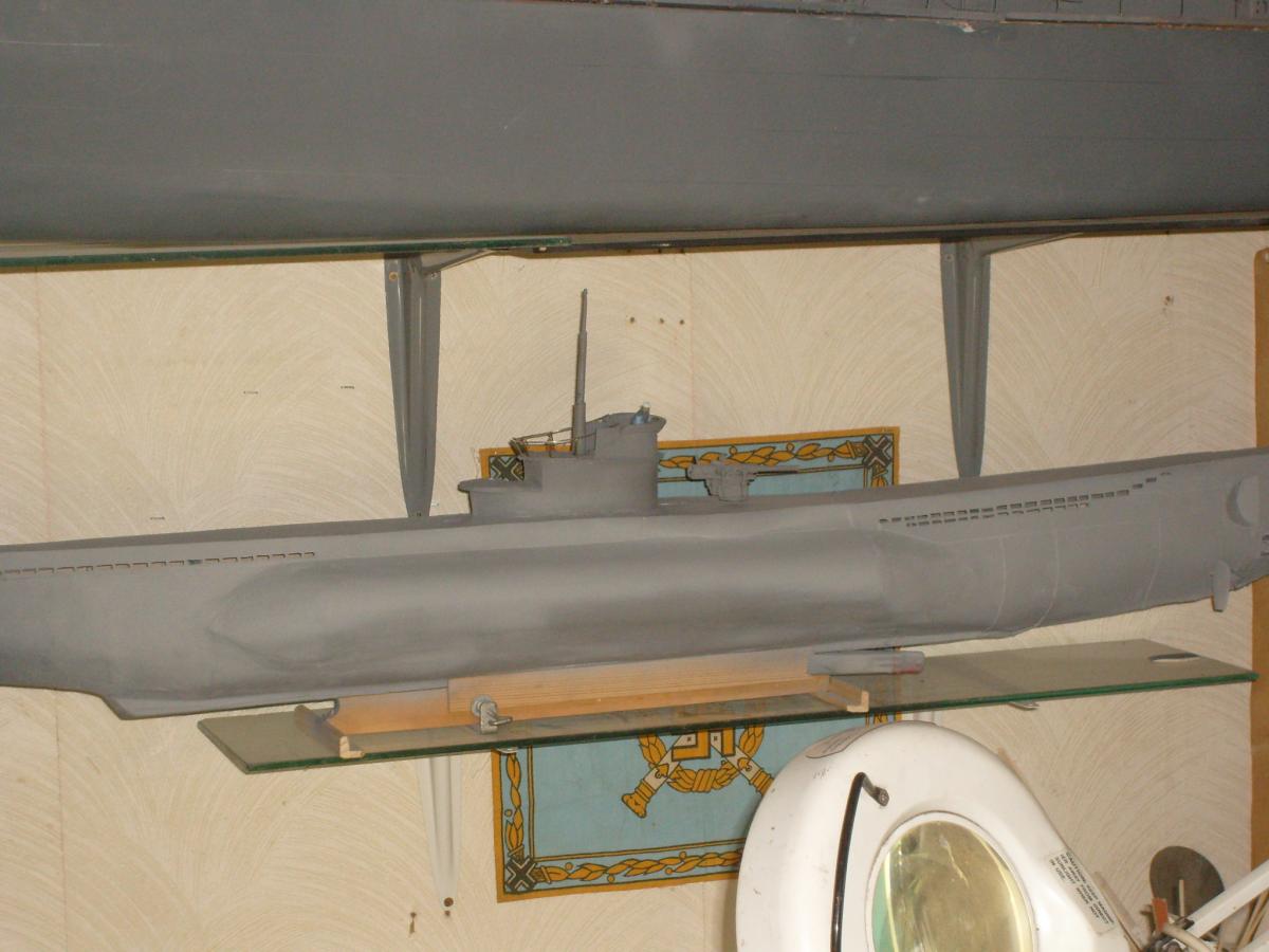

                  I have built several paper ships one being a type VII, to go with the 1/48 Fletcher that I have been piddiling with for the last ten years. built a 1/48 "Hawaian Pilot" Frieghter. For the hulls, I use wood a keel, with wood luan door skin, bulkheads using the ships scale drawings as to compartments placement. Then I sheet the framework with construction paper. The Frieghter's hull was sprayed with acrylac enamal primer, inside and out then polyurathane. The USS Kimberly's hull was laid up with the wood/ paper, Urathaned, then primer. It will be covered with sections of sheet aluminium, when finished.
