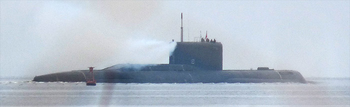

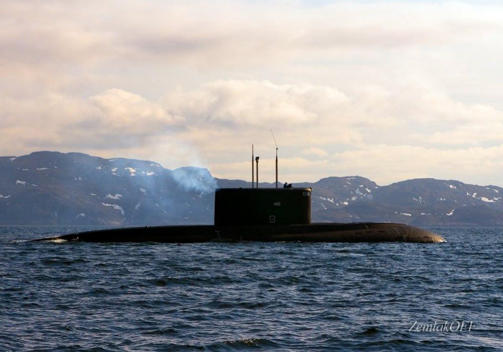

    These two pictures, one of the Sarov and the other of a Kilo, have the same thing in common. Worn out diesel engines. The tell tale ofcourse is the blue smoke. In the case of the Kilo its the Aux. diesel but still. In the Sarov, thats way too new of a boat to have this going on.

    Hate to tell you this, but that is a normal indication for submarine diesels.

      Indeed.
      If it ain't belching white smoke at start-up, it ain't right. Particularly American two-stroke types.
        Thats what I like about you guys, good feedback! There are some unanswered questions here. What color is the smoke and is it at startup? Although true, Ive never worked on a "submarine diesel" I do make my living as a diesel mechanic in a commercial environment. While I cannot deny you men have the hands on actual experience on a submarine, something is amiss here. Ive worked on John Deere, Cummins, Detroit both 2 and 4 cycle, Deutz, International Harvester,Isuzu, Caterpillar, and Komatsu diesels.A 2 cycle is a animal of different stripes. A Detroit 2 cycles design suffers from late ignition timing so they tend to be more smokey(grey) than a 4 cycle. If the Detroits smoke is blue it could be the supercharger seals leaking into the cyls. A four cycle that continues to smoke after startup has some maintanance issues. Either a restricted induction or low turbo pressure or too rich a fuel setting on the fuel injector pump(rack).I suppose it could even have damaged or worn injector valves. Now that I think about it, these are Russian engines , so all bets are off. Or are they?:wink:
          • 14012
          First boat I Qualified on was the TRUTTA. We had three Fairbanks-Morse, 2-cycle, opposed piston Main engines (The guppy 2A's gave up a Main, typically from the forward engine room). At start up, after rolling on air for a bit, then kicking in the fuel racks, black smoke would belch out the mufflers, almost immediately turning thick white, then quickly thinning out to a very light grayish smoke -- almost invisible at any significant distance from the diesel exhaust discharge (be it from a muffler or snorkel exhaust mast).
          Remember, at start-up, often there is a lot of sea water in the external diesel exhaust piping and mufflers under the superstructure, so it takes a bit of time for that to be flashed to steam and purged from the system. A component of the 'smoke' is often salt-water derived steam -- very, very corrosive stuff!
