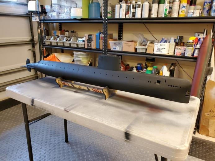

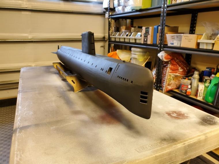

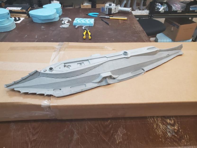

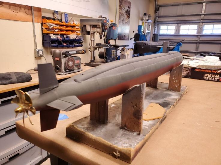

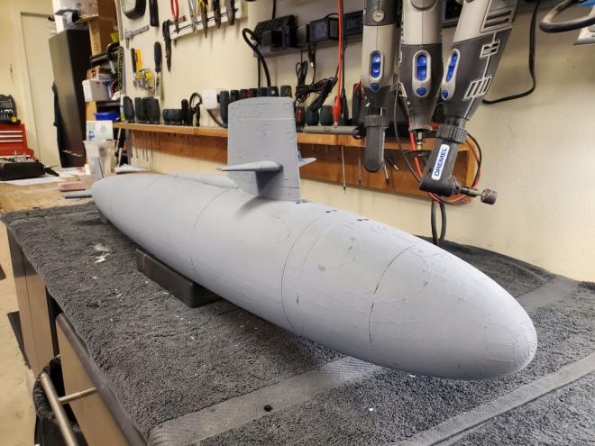

              I finished up the first prototype 571 Nautilus hull. This was done in 72nd scale and is really big. Too big for most hobbyists. I've since scaled things back to 96th scale, but this hull has found a new home and is getting shipped out as soon as the final payment is received.
ID:	139628Click image for larger version
ID:	139629Click image for larger version

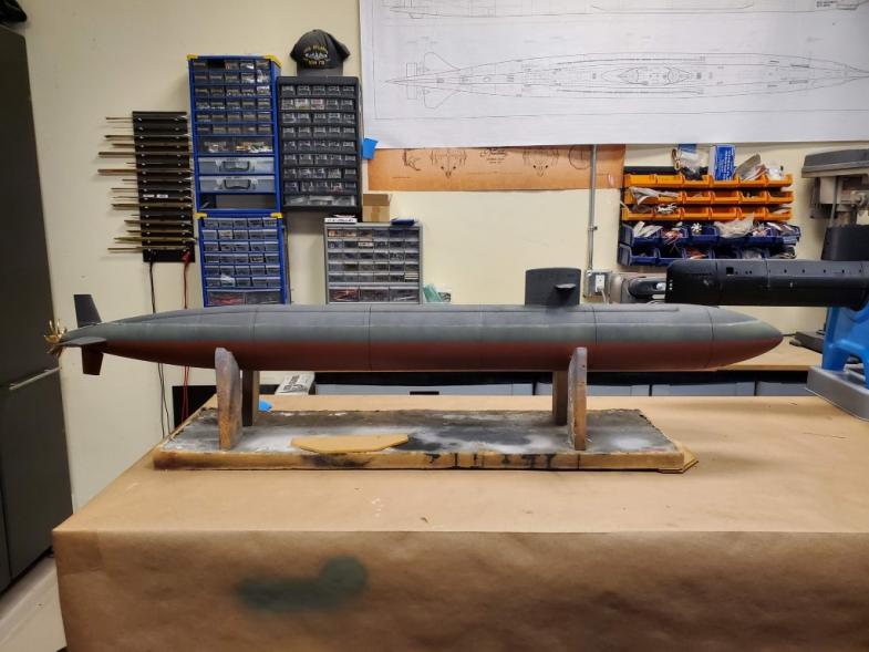

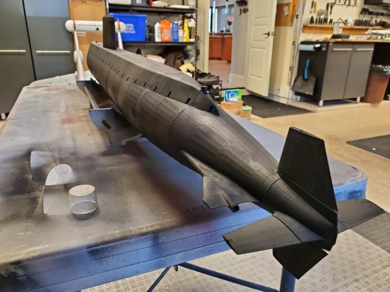

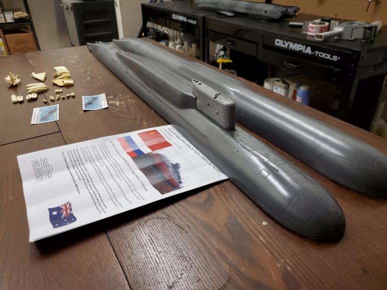

              I also offloaded the prototype 96th scale LA. I really like how that set of files turned out. This one is getting shipped out today if things go well.
ID:	139625Click image for larger version

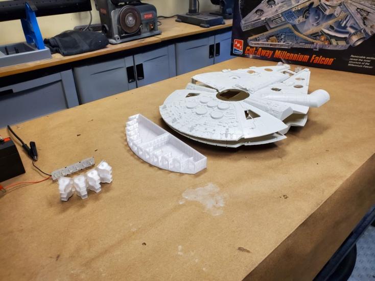

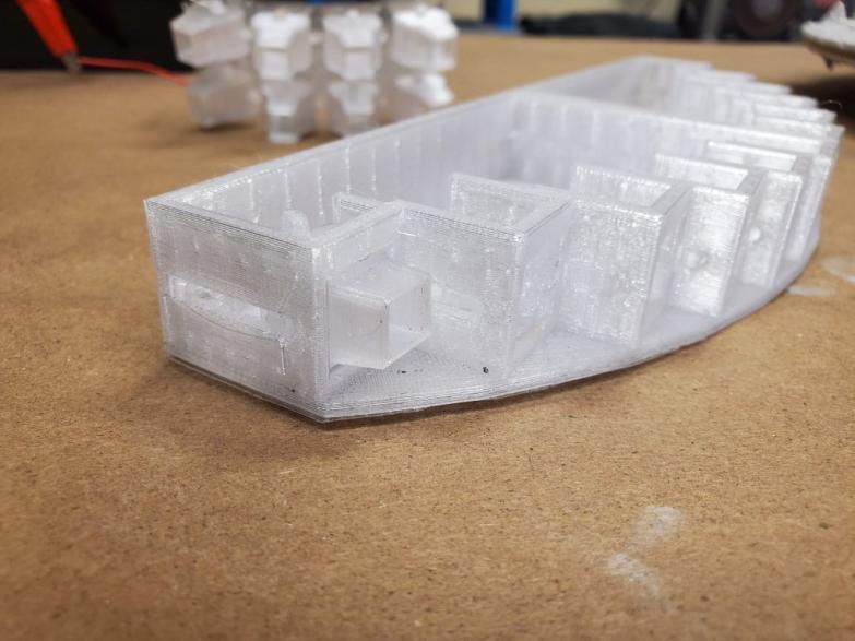

              Logan has taken on a new project! As avid Star Wars fans, one of our favorite vehicles is, obviously, the Falcon. So when Logan was coming up with his next project after the Batsub, we settled on this almost immediately. It will have no ballast system and be set up for full acrobatics (pitch, yaw and roll). A challenging engineering exercise to make it practical with no control surfaces, but I think we have that figured out. The propulsion will be a series of 12 nozzles, grouped in port and starboard assemblies. Yaw is achieved via variable throttle, pitch via pointing all nozzles up or down, and roll by orienting nozzles opposite left and right. All good in theory, of course.
              I 3D printed these in clear PETG plastic and we'll be backlighting in hyper blue LEDs, of course!
ID:	139639Click image for larger version

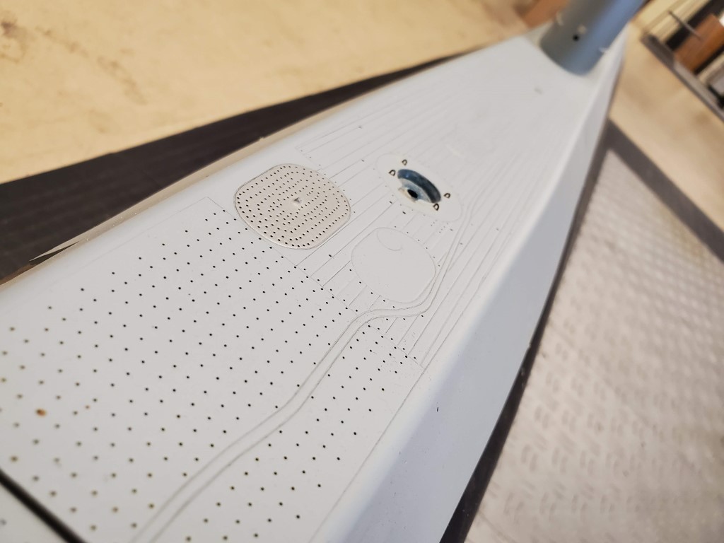

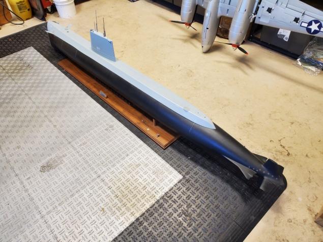

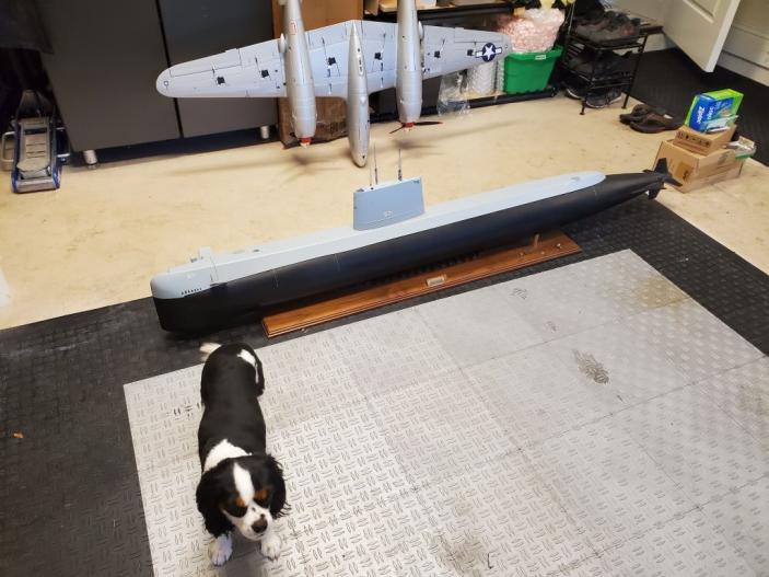

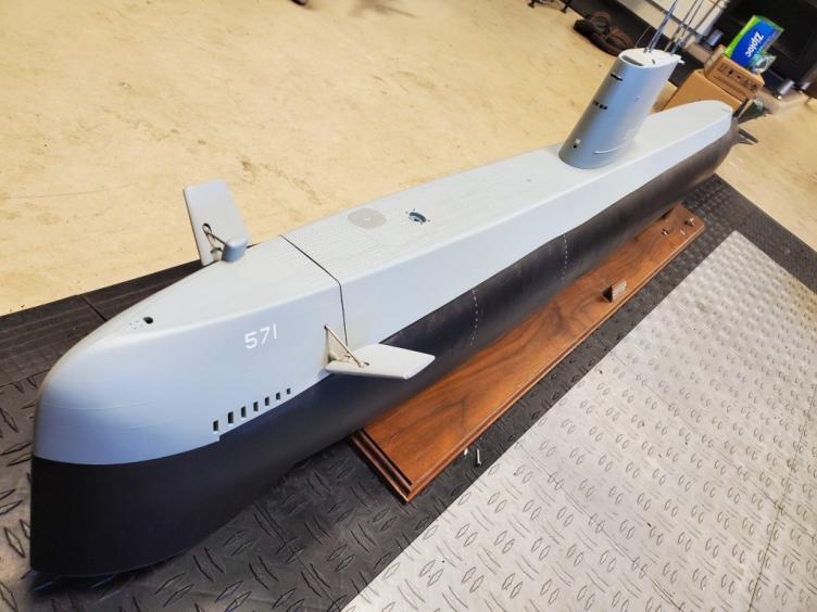

              I have also been working with an estate company out of Oregon to buy a big Deboer 571 Nautilus model. They had terrible photos and virtually no description. I took a chance and it ended up paying off. It's a gorgeous build and someone knew what they were doing, obviously hoping to RC the monster as the linkages are all run and hull access figured out well. I have plans to use the MSS methodology with the clear boxes.
              Yet another project to add to the list, but one I'm excited at tackling. In the meantime, it will make a beautiful display.
              To put this photo in perspective, the car mat on the floor is 8ft wide...
ID:	139632Click image for larger version
              Gorgeous deck detail on this boat!

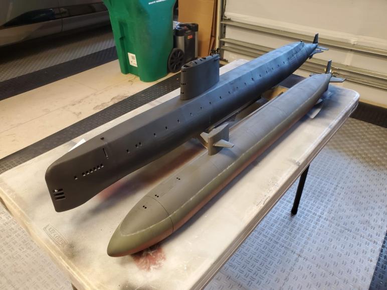

              LXG Nautilus got about 30 minutes of love yesterday, too. I installed the brushless motor that will propel her along, hopefully as a nice, quick pace.

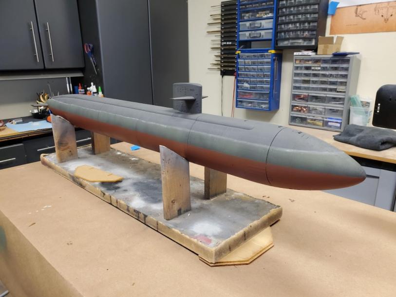

                    Great paint job on the 688! I have to agree with everyone on the 571 Nautilus that's a nice sub.
                      #70
                      Anyone can do that paint job in less than 30 minutes with three rattle cans and some pastels. Upper hull was Krylon "chalked" (not chalkboard paint, but designed to replicate the dark gray matte finish). Lower hull is red oxide primer. Green marine growth was Rustoleum camo. Pastel is simple white applied with a brush and rubbed into shape.
                      I was asked to throw a quick and dirty paint job on that boat, so that's what we got!

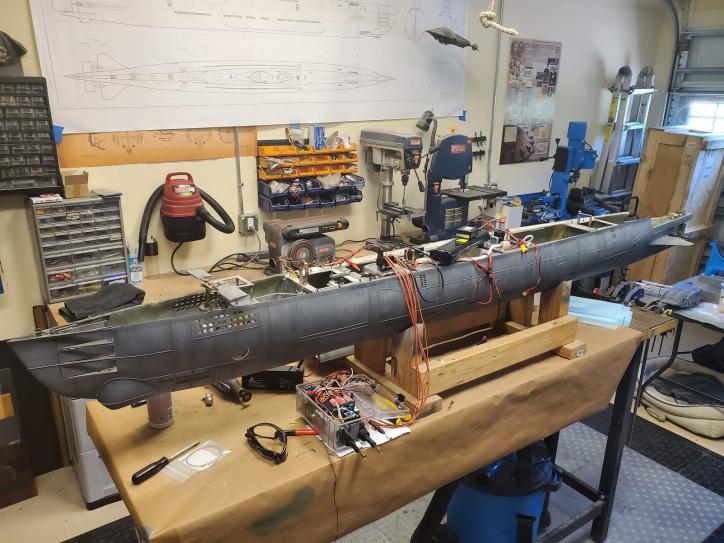

                            I'm happy to say that progress on the big XXI is still moving forward. Basic functions are all completed now. I'm working on tweaking throws for the retracting bow planes. After that, it's a final bench test of all functions, then adding foam in preparation for trimming. It may look like a bowl of cooked spaghetti, but once I clean up the wiring, it will be neat and tidy!

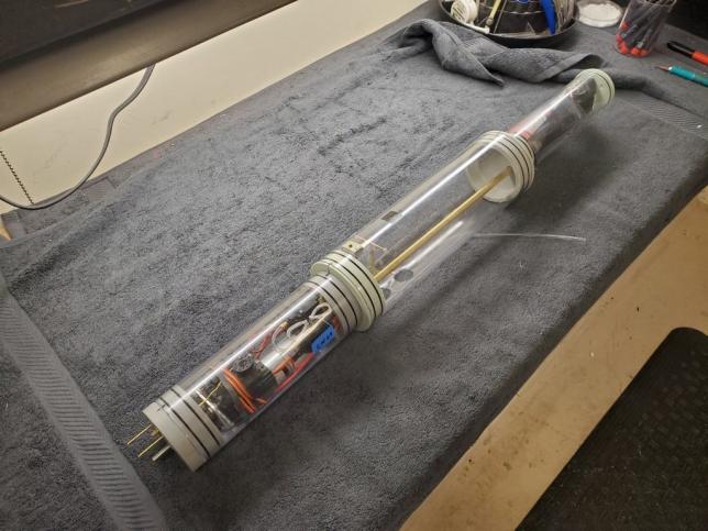

                            Thanks to his illustriousness, David M, I've got the prototype for the new 3" MSD SubDriver here. This one features a 3" motor compartment, a 3.75" ballast tank and a 2.5" battery compartment. It takes full-sized servos for the big boats and has a MONSTROUS air pump for the big ballast tanks.

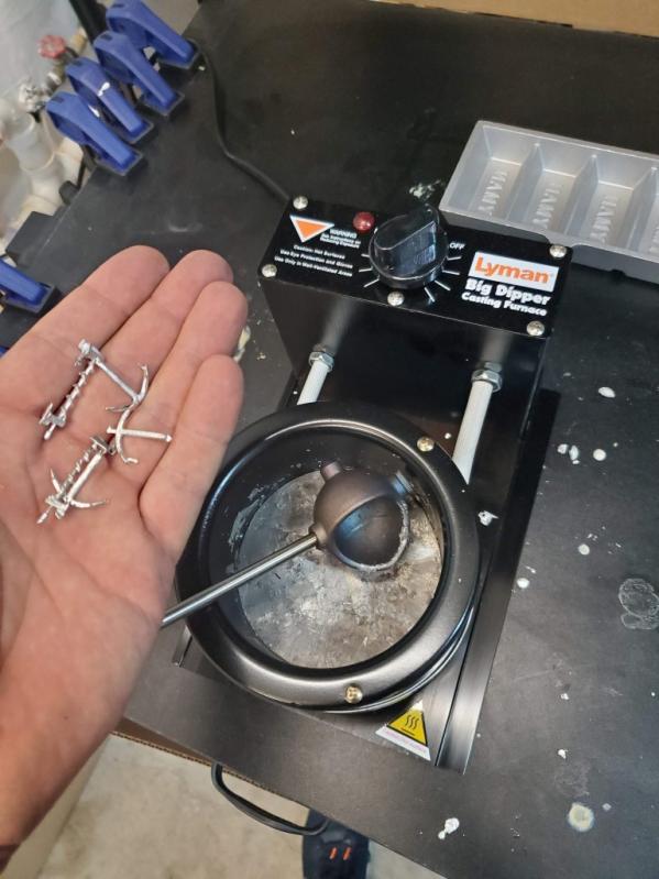

                            Part of the manufacturing of those kits is spin-casting, which involves dropping molten metal into a spinning rubber mold. We needed to *******ize a blood plasma spinner for this purpose, and this is the result. I'm waiting on a new splatter shield to come in and we'll be set to go on that front!

                            A few cast metal parts for the 31" Nautilus model kit. The tiny dipper in that setup is not suitable for casting the props and metal parts for the Skipjack kits. I have a new one coming in the next few days that will allow faster and larger pours. Learning as we go!
