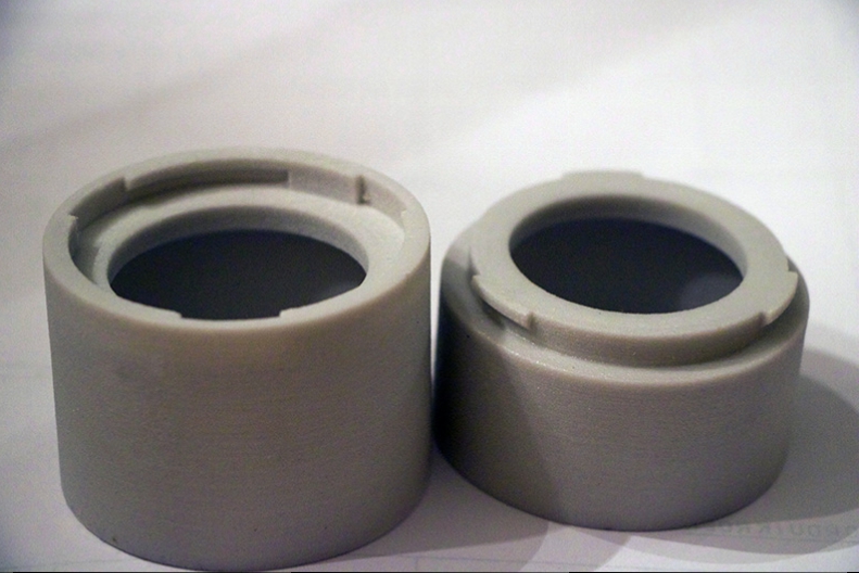

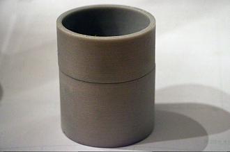

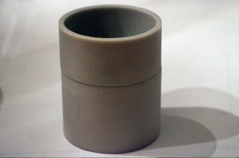

    I have been playing with making a 3D bayonet ring. So far I am to this point:
ID:	119175Click image for larger version
    It will fit into a 2.5" diameter polycarbonate tube that has a 1/16" wall. Very tight fit, so hoping that molding and casting will shrink just enough for it to go in a little smoother into the tube.
    Now working on putting in a o-ring. I am going to use axial type seal for now to see how that goes. Later, I may try to come up with a radial seal. Then other diameter bayonet rings
    So, I am looking at the 1.2mm o-ring with a 42.4mm OD. This size fits nicely on the flat surfaces I created on the female portion and male portions of the bayonet rings. I could go larger diameter, but the OD sizes becomes an issue for this 2.5" tube.
    Any advice is welcome! I re-wartched Andy's video and am using his suggestions on the amount of o-ring to be proud as well as space on the sides. Well not completely, I am making it a little higher just in case I need to mill out the groove, I have the room to do that.
    I have BJB resin, it is the clear stuff. I am still learning on it, but it has little to nil shrinkage and high strength too. That brings up ware and tare on the parts. How well will it hold up, maybe a radial seal might be better....just rambling thoughts.
